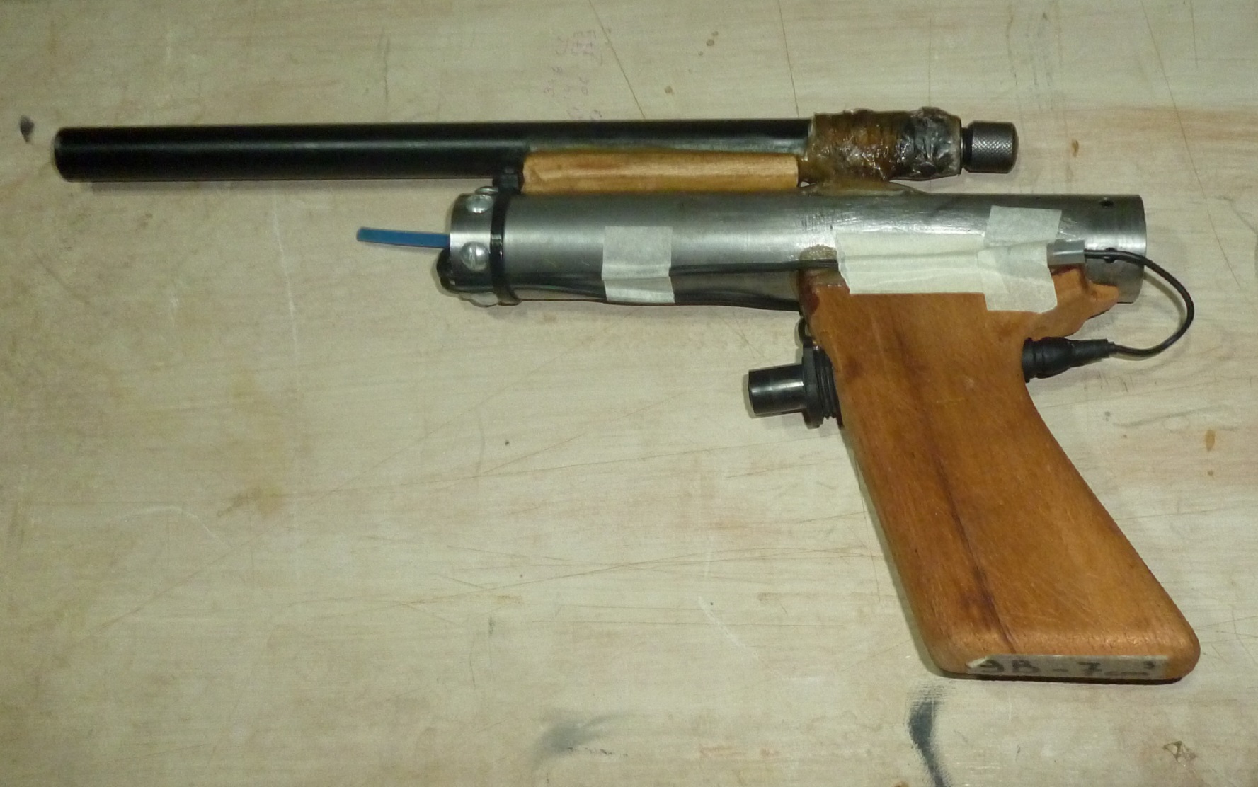

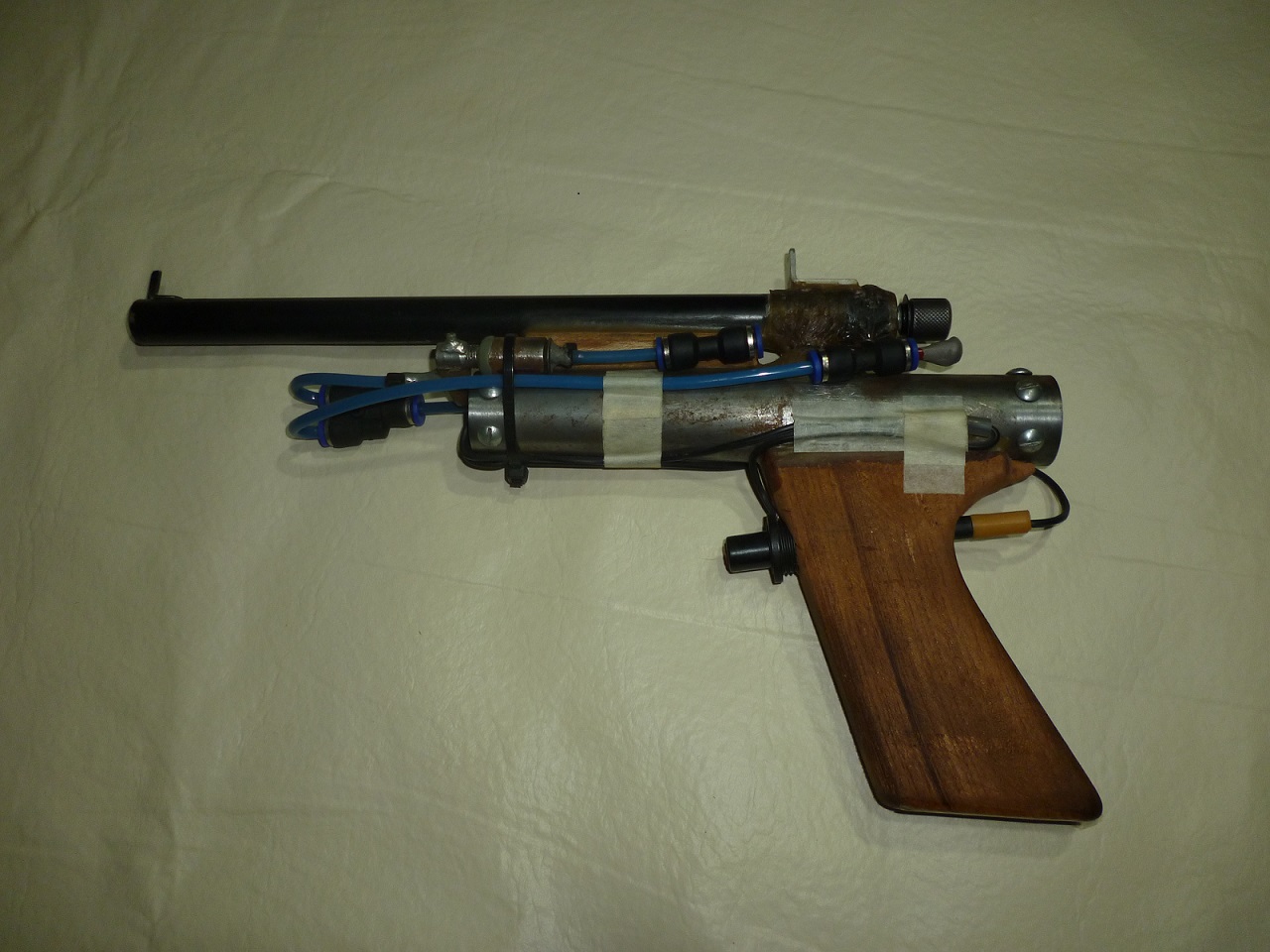

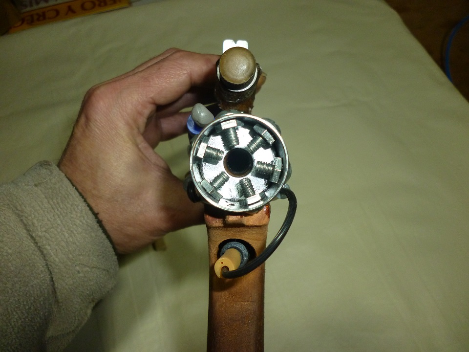

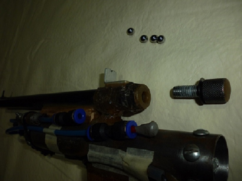

I am testing this small 7X hybrid that shoots 1/4 "steel spheres, it has the new hybrid system, with a spring, I have also finished the charging station with the new gas rapid doser design. I have to make the corresponding video to share it. The only thing I found unpleasant is the damn bounce of these steel balls on certain hard surfaces .... :x
The firing barrel is a brass tube and the barrel bore is smooth, made of resin, and lubricated with a little bit of graphite. It has two connectors, one to decompress the combustion chamber and the other to load the mixture through the check valve seen in the photographs.

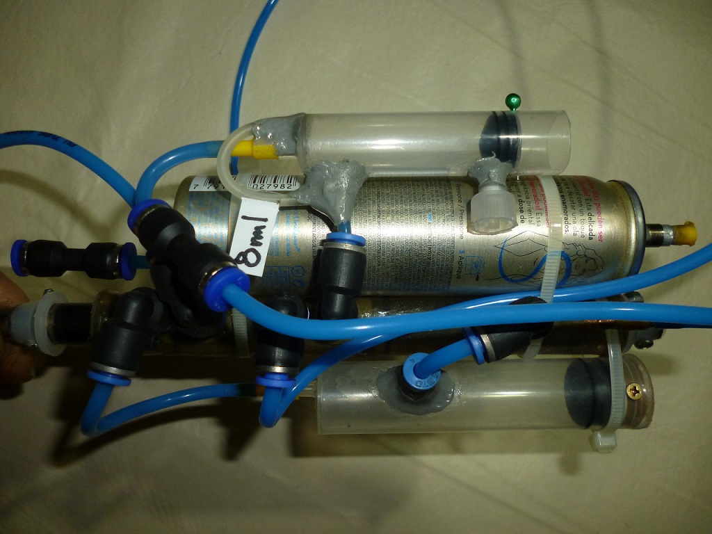

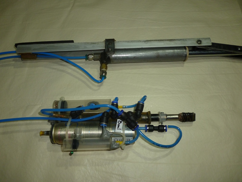

The charging station consists of this air pump and a liquid butane tank, the 8 ml dosing device, the gaseous phase tank, and the 6-way valve and two positions. It works like a clock and the shots are totally the same. It was impossible to cough this into the little gun so I set it aside. The mix loading system works for all my weapons. Only the syringe dispenser is replaced.
The ammunition fits tightly in the barrel. It is loaded from the back removing the screw that can be seen in one of the photographs.

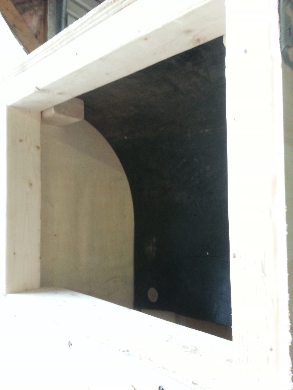

Steel balls are bouncy, my target has a thick piece of rubber at the back to absorb the energy and points them downward so I can collect them.
Argentina
Posts: 1064
Location: Argentina
Has thanked: 274 times
Been thanked: 276 times
Wed Jul 11, 2018 9:40 am
I have to make something similar, to shoot inside my little workshop, although I am shooting with this to "lost ammunition". Do not bounce your steel balls? I shoot a can of soup and back I have a cardboard box with 30 cm of compacted newspaper. There I pick them up and they can not bounce like that.
