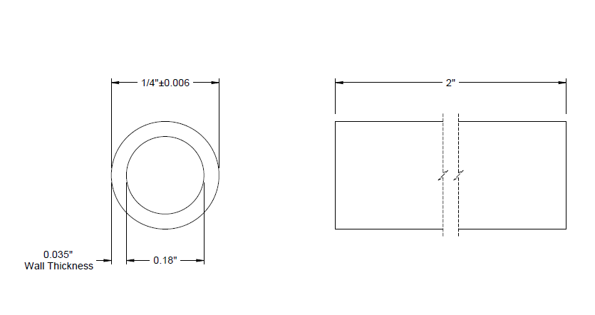

That looks good thanks, was looking at this tubing for a smooth bore, it is 4.572mm ID so could work with the right pellets.

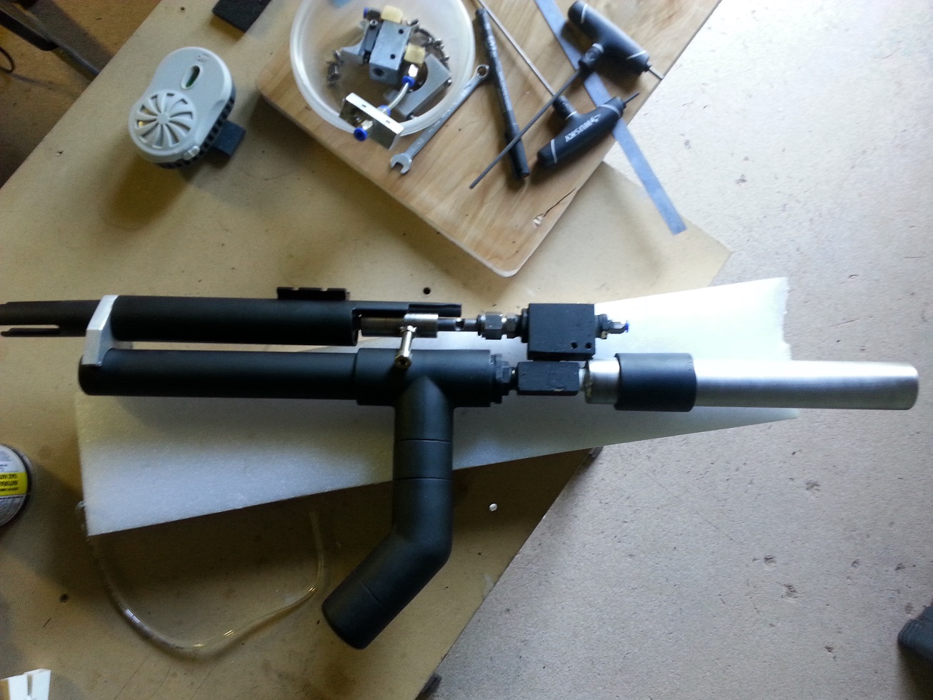

Hello, after playing a bit with my primitive QEV & slide valve rifle I wanted to build something nicer. I browsed a bit for ideas, read about those nice trigger 3 way 2 position valves, ordered one, it arrived. Inspiration has been this project: http://www.spudfiles.com/pneumatic-cann ... 26765.html
First of all, one hole is off centre, spoke with the seller and he says it is actually so, and in another listing which had pictures of the holes it was actually off centre as a new design. I guess this will be the port completely open to the atmosphere. Second picture here, mentioned in another thread, bought the same one:

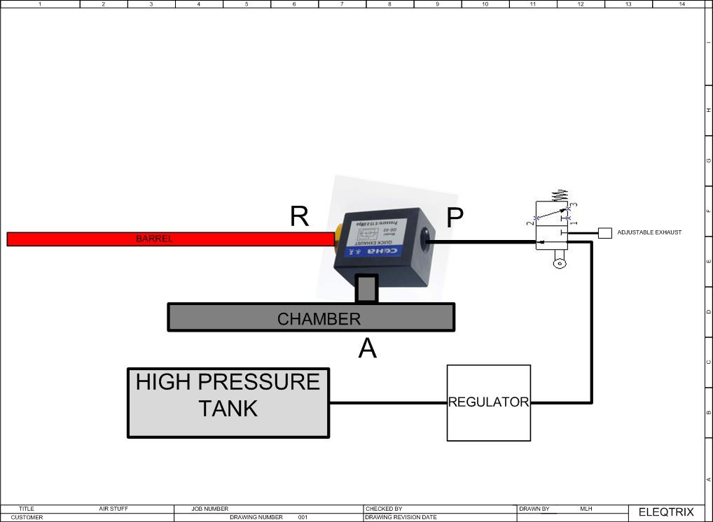

Tue Jul 24, 2018 5:35 pm
If you don't modify the QEV I think this should work.
Now I realise the sealed exhaust wouldn't work as it doesn't vent to atmosphere after firing. :shock:

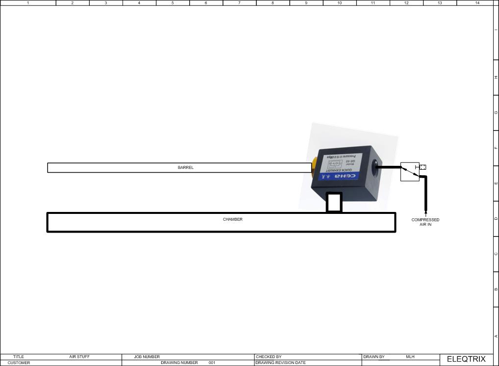

Wed Jul 25, 2018 6:03 pm
That's a good layout for a single shot as it will dump the whole chamber , that's how I did mine.

KnooBill wrote:Currently by my super scientific method of blowing into it
Hey, it works ;)
I can tell that A and R communicate while P is closed, when the trigger is pressed P communicates with A. As I don't want to drill small holes into my QEV, should the connection be QEV P (pilot?) port --- JM-07 P (pilot) port?
If A is the common port, then it should be attached to the QEV pilot port.
If A communicates with R when the valve is at rest, then R should connect to your main chamber, while P should be left open.
an adjustable chambeto find which volume suits me best?
Easier to use GGDT to determine what size of chamber will give you the performance you're after.

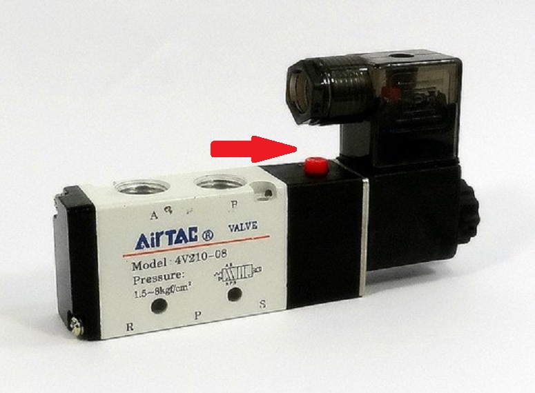

Fri Aug 03, 2018 11:52 am

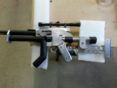

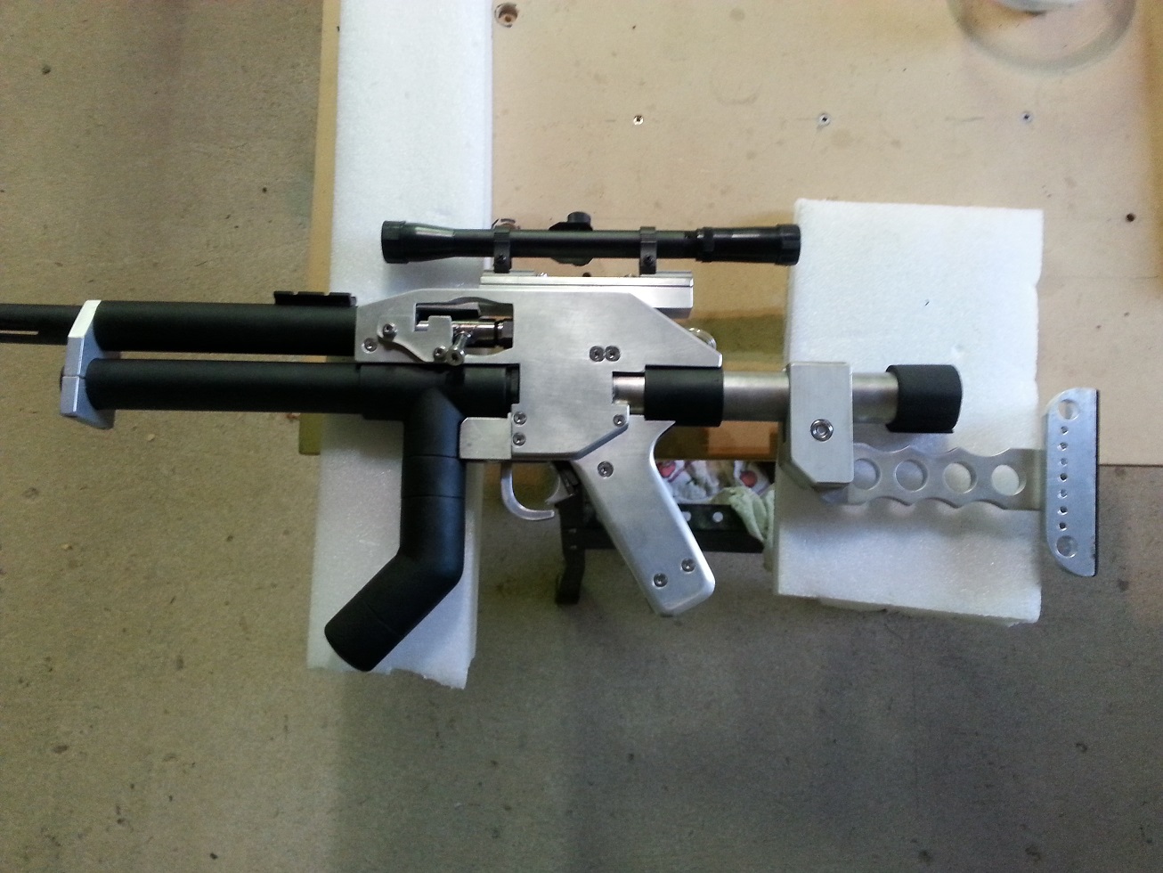

Does anyone know what this red knob is for?
Fri Aug 03, 2018 12:06 pm

Fri Aug 03, 2018 2:12 pm
:) Solved!
