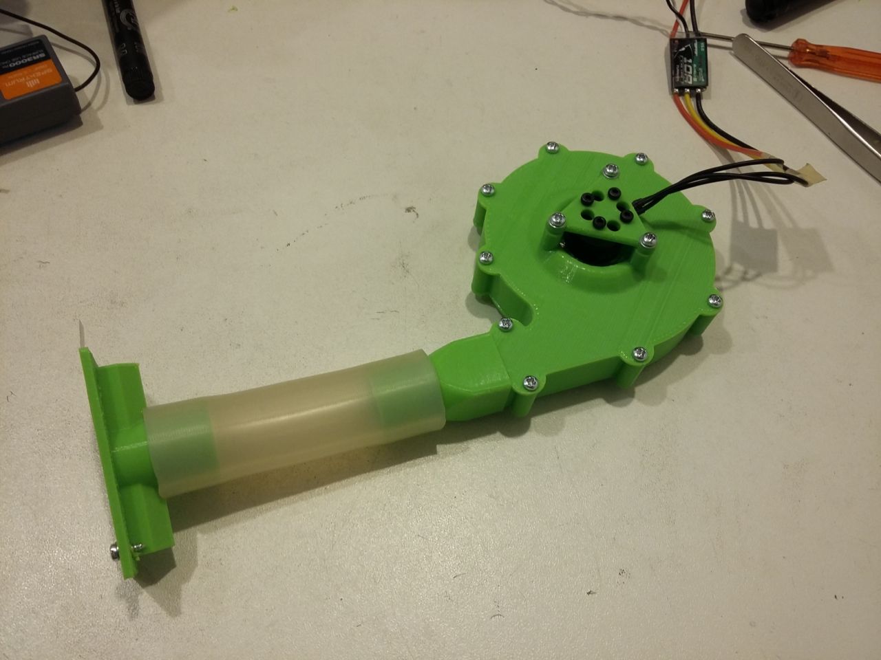

So I tested 2 things today: Reed valve function and minimal mixer assembly.
First I 3D printed a white tube where I fitted the propane nozzle. Plain and simple construction. See pictures.
Then I fired the sound cannon indoors (with hearing protection) and turned off the lights. Now I could clearly see how far back the flame got, and I could clearly feel the blast of hot air coming out the radial fan. I repeated the test with the reed valve in place. After this, I'm reconsidering to dump the reed valve. I'm sure the radial fan will last longer with a reed valve in place. I just need to work a bit on the design.
And the simple propane feed is working perfectly fine with the radial fan feeding the air to the sound cannon.
