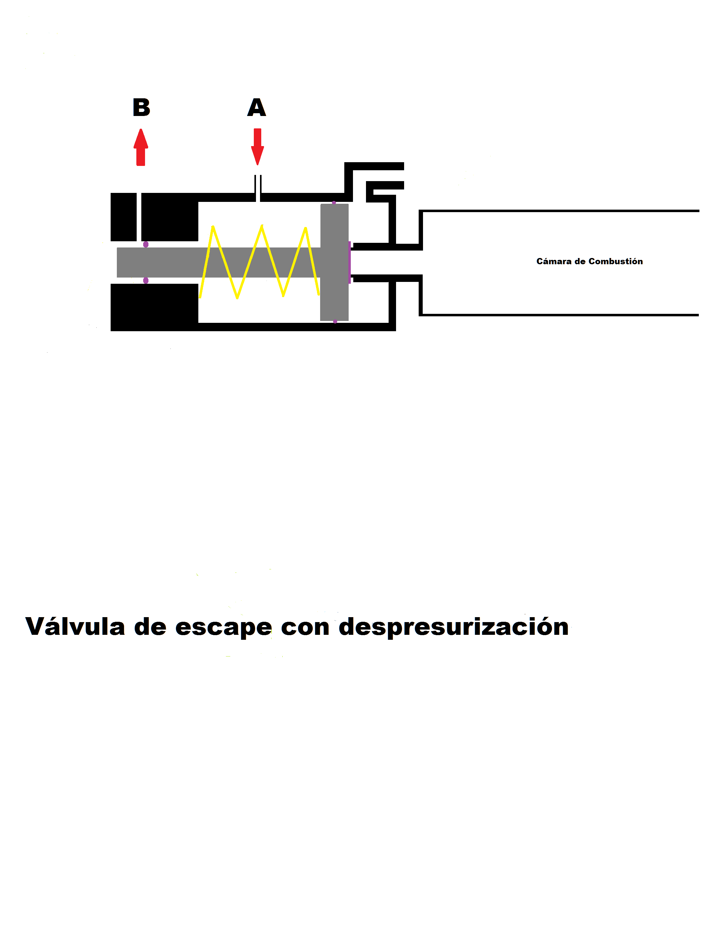

I have tried the system a lot and I have not had these problems. The interior of the combustion chamber is always absolutely clean, free of dirt, as in a piston-type combustion engine. It only communicates with the outside, at the moment when the gases leave at high speed and pressure, from the inside out, so it is imperative that something can enter. The o'ring does not burn, as I observed in the experimentation. I use the commons, but I will try to use viton, if necessary. What does damage the o'ring is if the exhaust hole is not very well polished inside the tube. For the rest among all the prototypes that I have built with this system, about 3, and I have fired them countless times, they continue to work correctlykeks2033 wrote:I think, on temperature and dirt rubber seals quickly deteriorate

Nice design but impossible to do for me, it is more complicated, in practice. The one I propose is simpler and works well. I just have to give a turner the plans to make the two lids and the piston in steel, which are very simple elements. Until now they were epoxy resin, but for 10 -12X, they must be made of bronze or steel to last.keks2033 wrote:You can do so. On the red piston, too, there are rubber seals that would be tight. The area of the red piston is small, so there is no need for a strong spring. The green piston can be made without a spring so that it can open the gas outlet completely. A bit difficult, but I'm sure you get the idea.
I have tried something similar to this that you tell me.
Thanks for your opinion and the diagram.
