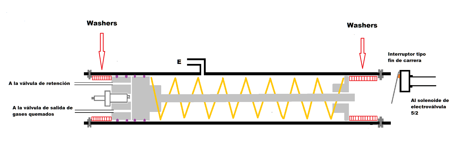

I tell you the following.
I have tried to regulate the opening time of the exhaust port so that it opens before or after. This is achieved by increasing or decreasing the washers, (in red in the diagram), which ultimately moves the piston closer to the outlet orifice. There are important variations in the energy of the shot. The best performances are achieved when it is two or three millimeters, that is, when it does not take long to open. The mass of the piston and spring have to do with this question.
The amount of washers is always the same, so as not to alter the force that the spring makes, they are only taken from one side and put on the other, and the other way.
On the other hand, the ammunition in the firing barrel, which is tight and seals well, retains the gases a little more. Shooting without the ammunition, only produces a soft "puf". When I insert the ammunition, it makes a strong explosion, and I think it is for this reason.
I'm going to make a short video this afternoon so they can hear the difference.
I conclude that to achieve the normal pressure peak in a hybrid, one must consider the combustion chamber, and the firing barrel seal, as unit. Only this way works. The opening time depends on the mass of the piston and the spring, the distance from the piston to the exhaust port. The further away, the later it will open. I have played with this.
It is different with the rupture discs, which produce the peak of explosion pressure, with the combustion chamber alone.
It's a good system that Jack shows here, it's a matter of trying, to try.

Effectively. The system has that disadvantage that you make notice. The only thing that makes me consider it to use in these prototypes, is its incredible ease of construction, and the possibility of regulating some parameters.
I have built a regulation template, (photo), and based on the program data to calculate the dimensions of the spring, I configure it to perform as best as possible.
Speaking of theory, I imagine a piston engine. and I compare it with this type of combustion chamber system.
Actually I do not think that the force exerted by the piston due to the expansion of the hot gases, differentiates as workload of the "engine", between a spring and a crankshaft to move. The more compression pressure the mixture is used, the harder the spring must be and the more energy it will need to be compressed. That energy is provided by hot gases, and there is no more.
Personally, I tend to use cartridges with rupture discs, which consume much less energy from the thermal process to open the gas outlet channel, and especially much faster.
That's why I commented in a previous post, that cartridges containing the ammunition, the rupture disk and the dose of fuel, would simplify the installation a lot, and more energy should be available to boost the ammunition. It's just an idea.
with a rupture disk, like the first one I built.
It's good design what you propose Jack, I'm studying it, and I'll comment if I can do something like that, within what I can build.

Jack, in his diagram, the combustion chamber can be cleaned like this. The piston "E" moves back to the right until the auxiliary spring is totally compressed, in the compression and explosion phase. When the cleaning valve is opened, it moves to the left by the action of the auxiliary spring. It is just a thought... :roll:
A good one! You would only need a very weak spring to clean out the chamber so it shouldn't have an appreciable effect on firing. In terms of proportion I would make it something like this, with the port slightly larger than the caliber and the pop-off piston roughly twice the diameter of the port:
I'm not sure this would be a superior solution to using the projectile as the pop-off element, as long as you intend to use regular shapes like BBs.

All right. I can build on what we are talking about. It is more or less as simple as what I have already manufactured. The auxiliary cleaning piston spring must overcome only the resistance of the ring. The ignition can be included in this cleaning piston. It seems to me an important improvement to leave more energy available for the shot.
The other "solution", that of including the ring to retain the ammunition, does not solve the problem of excessive energy expenditure that we are talking about.
Otherwise, I refer to the general system, it remains the same.
As soon as I can, I'll get to work. Thanks Jack for the ideas and advice.

The system could be simplified, using the auxiliary piston rod to move the ammunition loading system slider. Without the mechanical actuator, the air consumption will be optimized, (which is the basic reason why I have chosen to use springs and not a pilot air chamber).
The ignition can be included in the same auxiliary piston.
The back cover of the combustion chamber can have a regulator to vary the compression of the spring, "R" in the diagram, and play with this to achieve that there will be at different pressures, to optimize this theme.

Cute design It may be possible to use the auxiliary piston rod to open and close the burnt gas outlet valve as well. The two little actuators disappear. I have not analyzed it yet but I think it is possible.
