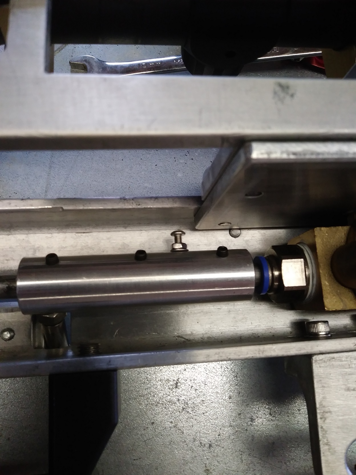

Would a piece of O ring material work as a hop up ? or would it be too hard ? I need it more to stop the BB's rolling down the barrel as well.
hop up.jpg (16.41 KiB) Viewed 9720 times
Wed Apr 10, 2019 7:21 am
It should work, this design is used in several airsoft models.

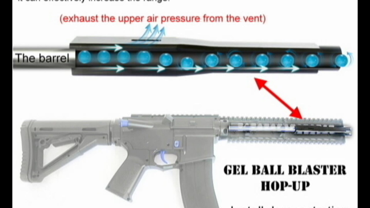

Anybody tried this air bleed idea as a hop up ? downside is it bleeds of some air but there is nothing to wear, a rubber sleeve covering the hole could be used as adjustment :idea:

Sat Apr 13, 2019 12:17 pm
Tried the rubber hop up thing, it seems to work, at about 120 feet using the scope I can see the BB dip slightly then climb :D

Agreed, the point of hop-up is to compensate for low projectile density and velocity by providing lift. If you're not limited by safety considerations for skirmishing, pushing heavyweight (0.45g+) BBs at higher velocity should give you longer useful range regardless.
Tippmann actually use a curved barrel in their "flatline" modification to generate backspin in their paintball markers:
I believe some early airsoft guns also used this system.
For "our" purposes however, I believe that using denser projectiles fired at higher velocities is a better path to longer range.
