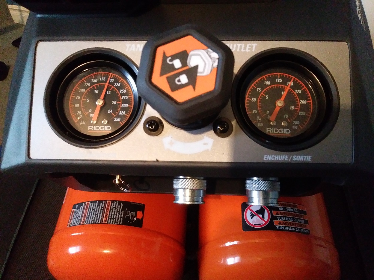

Easter Bunny came

Oh that is monstrous! What a beautiful sight. I'm sure you'll have fun with that thing.
Sun Apr 21, 2019 5:51 am
These eggs keep getting weirder and weirder :D
4.5 gallons at 200 psi, that will make for a nice higher powered BBMG...

The specs stated for the compressor are a bit misleading but having read several reviews I knew what I was buying, would have considered the DeWalt but it gets some bad reviews related to mechanical parts (compressor failure)
The Ridgid has 200psi max TANK pressure, 150psi max regulator output pressure and most important, cut in pressure is 165psi, so it will maintain 150psi.
Sun Apr 21, 2019 6:53 am
Ah, boooo...

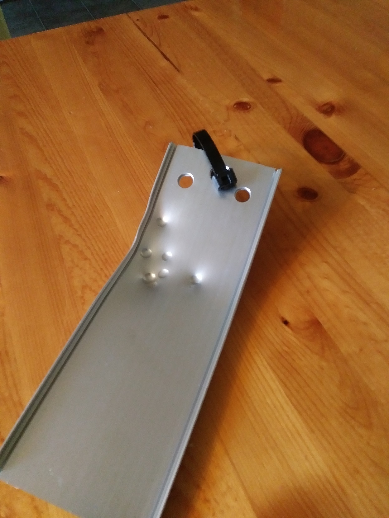

Has anybody ever sourced 10mm rubber balls ? I would prefer Ebay (easier to pay) but can't find any. Alibaba has loads from China. The BFG is pretty hard on targets with steel BBs, and rebounds are no fun.
This a piece of 2mm aluminium at 9m :o

Congratulations on being one of the few spudfiles members that thinks that his creations are a little too powerful ;)
