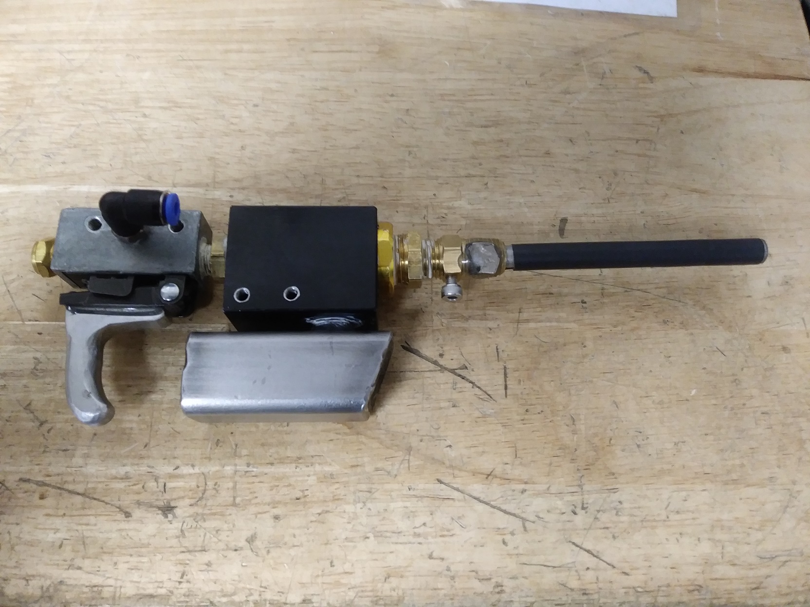

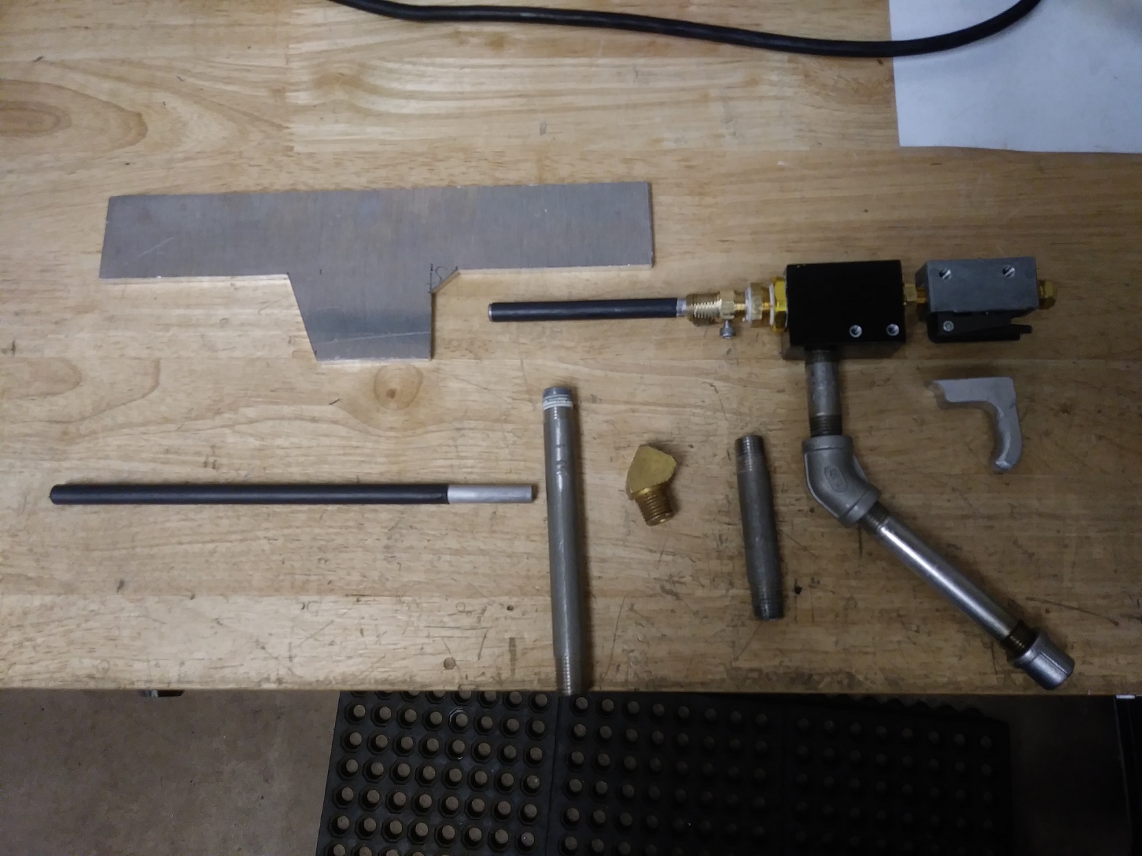

A few parts lined up for a simple 4.5mm BB pistol, 1/4" QEV, 1/8" 3/2 lever valve for trigger. Interchangeable barrels
Single shot muzzle load with a magnet to hold the BB

Looks good, though I would say the chamber is far too big, most of that air is going to be wasted. You should really try for higher pressures in a much smaller chamber, especially with the small caliber and all-metal construction.

Ha Ha yes, I am fabricating a square chamber which will be hidden by the side plates, still has at least 4x the 8" barrel volume
Not normally recommended as a pressure vessel... though I imagine the wall thickness is completely disproportional to the pressure you will be using.farcticox1 wrote:square chamber

The tubing and end caps are 1/8" stainless, won't see much more than 150psi.
So this is the heart of the beast with the 5" barrel, pretty simple (KISS) just needs an air supply.

Original plan was to use only threaded fittings for the chamber just to see what I could make by screwing parts together
I know not everybody will have access to welding equipment, all I have is a drill press and the Tig welder is where I work in the maintenance shop, but when I realized I could get a decent size chamber hidden between the side plates if I made it out off 1" square I couldn't resist.
