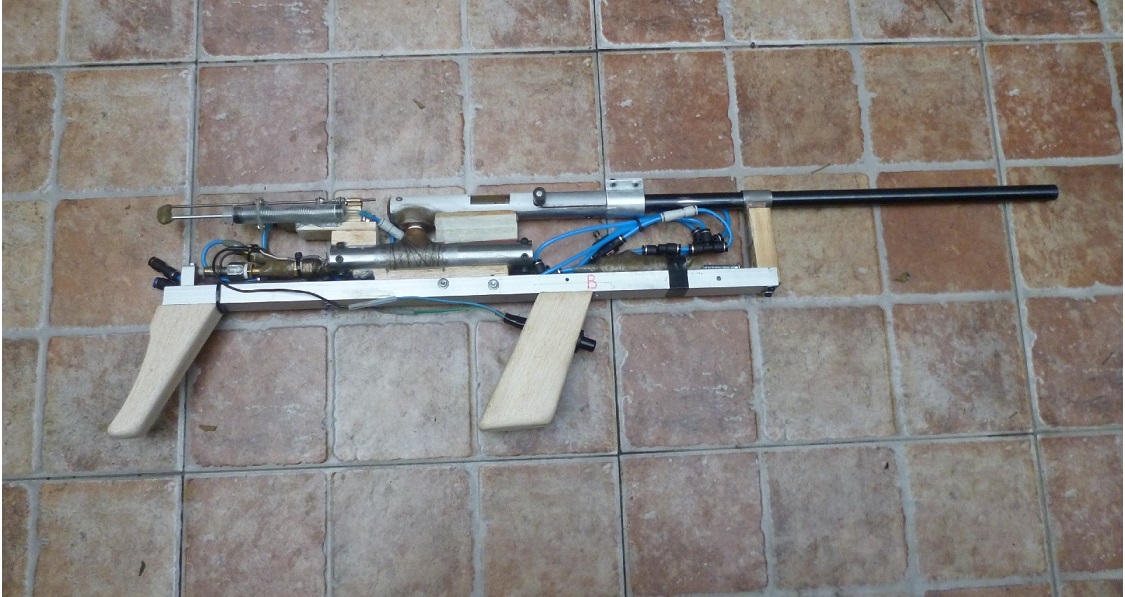

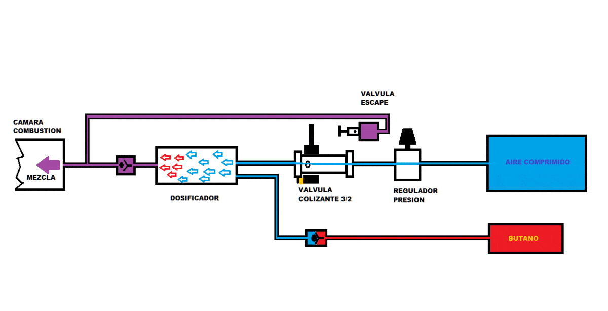

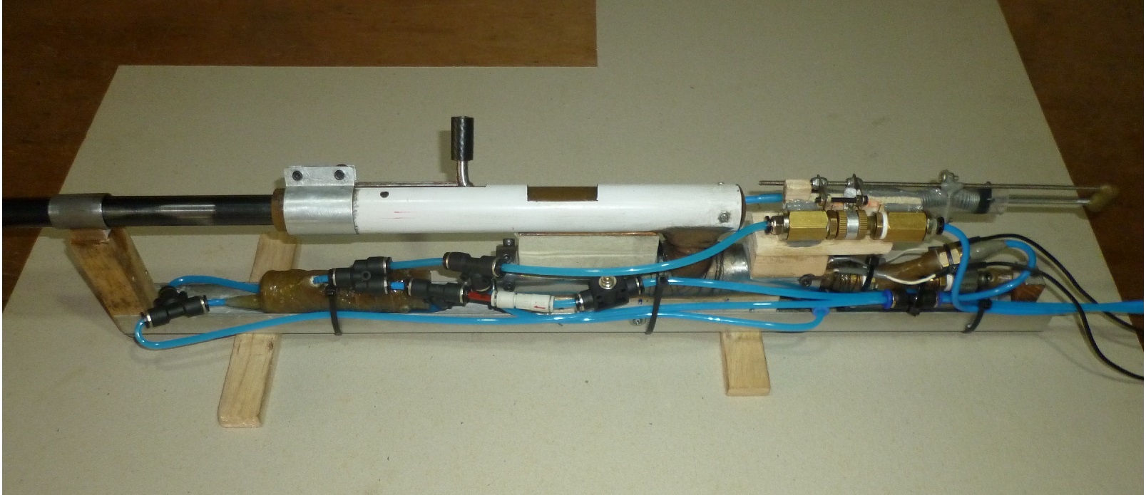

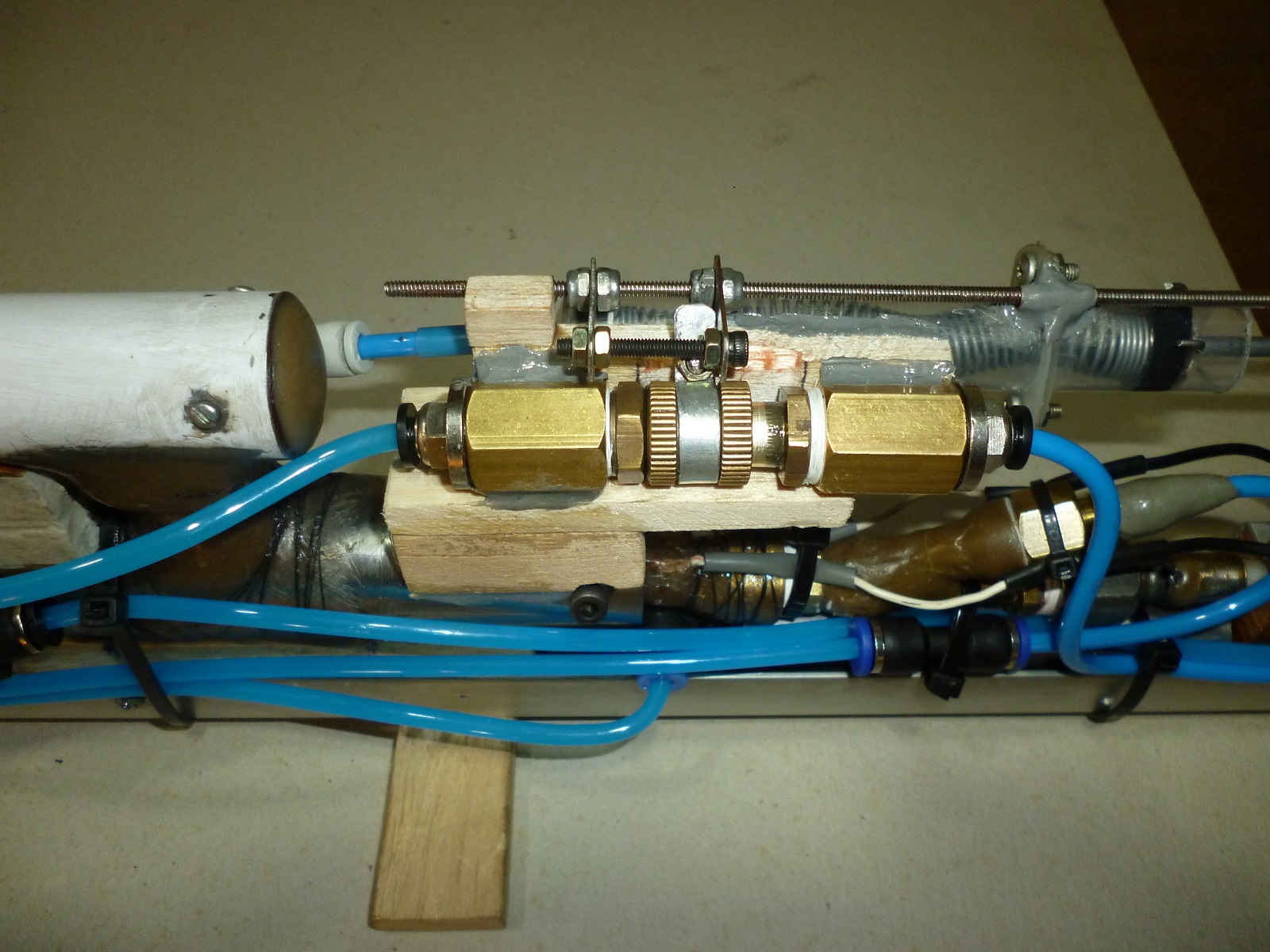

I carried out tests of the system for repetitive firing of the new hybrid that I plan to build :D The caliber will be small, (according to my possibilities of making noise and space), .25, with steel pellets or diabolo, I have not decided yet.
n the tests, I'm using diabolos, because I already had this ready, and the test facility, (not weapon), with recycled elements that I keep just for this.

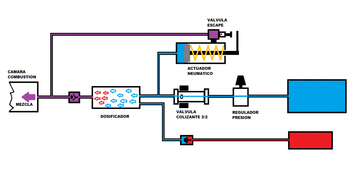

It works perfectly, I've fired it many times. I leave some photos, and some diagrams.
The "Pneumatic timer" is used to determine the gas inlet time to the doser, about 1.5 seconds. The idea is simply to pull the handle and release. This automatically performs the opening and closing of the exhaust valve, the gas charge and its dosage, and the butane-air mixture charge in the combustion chamber. The system is relatively wasteful, a little air, (is a problem that solves many other problems, more important), in favor of having on board the weapon, the smallest possible number of elements.
If the ammunition is spherical, the operation is reduced to firing and throwing and releasing the crank to make the next shot. The system is the same as I have in my semi-automatic hybrid, (sliding actuated by pneumatic actuator). If the ammunition is pellet, you have to manually load the ammunition and titar and release the crank, and is ready to shoot. In the latter way, I am testing it.
By not using electrovalve, the load pressure can reach up to 15 bar, although I'm testing it at 7 bar, to adjust the design. Today, in the afternoon, I will make a video of the tests. :)
At the end of the post there is an animation of the system. Open the image to see.

thanks Moonbogg I show you a simpler version yet, which I was thinking.
All this is for small hybrids, which is what I do. I have not tried it but I'm totally sure it works well. It barely has a doser, a check valve, and a colizante valve with exhaust, (three ways, two positions), I mean with all this, the dosing system, and power. It no longer has any pneumatic actuator. Just move the valve one second, (as the animation shows,) and release it, and you have the combustion chamber, (any), with the built-in mix, ready to shoot. Very practical. Al final esta la animación.

My friends have nicknamed this prototype as "Machine to eject pellets", and some, (musicians), have asked if it starts, and can fly... :) I was able to get rid of the solenoid valve, and its pressure limits, thankfully. :D I'm going to let myself get carried away by the mess, a little, and install what is necessary to aim and shoot.
Edited:
I have installed the basics to be able to shoot with the prototype in my hands and I really liked how comfortable it is to operate. :D It is rather short, it does not reach 1 meter, and it came out light. I am now, thinking about the construction, improvements, materials and all that. Of course I'm going to raise the pressure of the mixture to about 10 bar, but in this prototype I did not think it was prudent, because it's one of the first combustion chambers I built, a long time ago, and it does not contribute anything to the design test In herself.

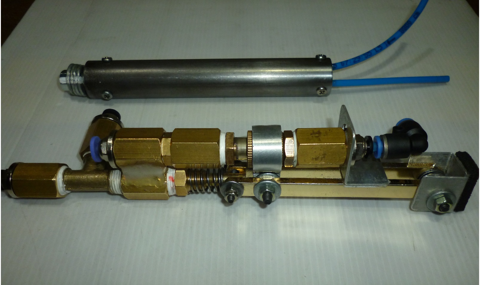

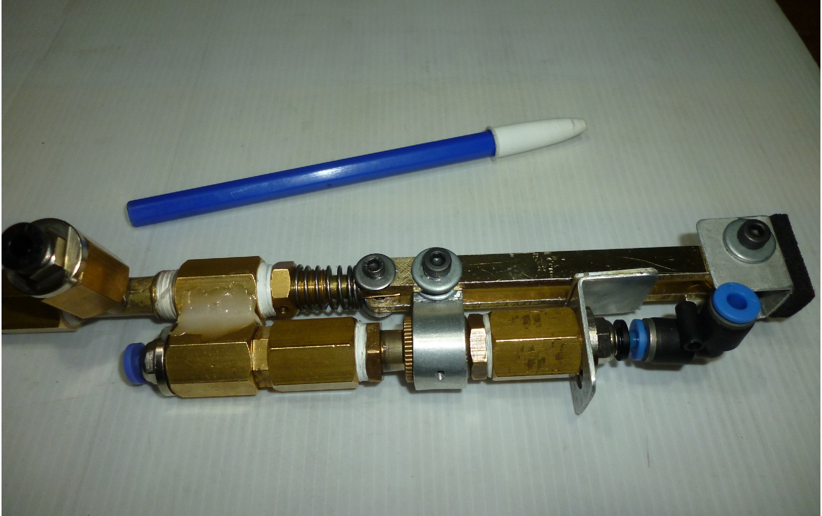

The simplest system just built. It is in relation to size with a common pen to get an idea of ​​the actual size. It consists of the valve body and the variable volume dispenser, (it serves me for several future weapons).
The valve body was designed based on bronze elements, of those used for gas installations, thread 1/4 "bspt, it is very solid, and just press the rod and release, leaving the combustion chamber clean, to zero volume, the dosed gas and all compressed in the chamber, ready to fire, between firing and firing only 5 seconds is necessary, the rest, I mean the firing pipe, ammunition loading and retention system by o´ring, and combustion chamber, is roughly the same as those I have built in the past.
The dispenser was built with a 1 mm thick steel tube, 20 mm inside diameter.
The whole set was successfully tested, it actually works flawlessly, and only consists of these two elements. The test pressures were between 6 and 11 bar, which are the compression pressures that I use in my small-caliber hybrid weapons.
I have thought about installing all this, in a test weapon, (apart from the one above in this publication), to finish making the adjustments. This dispenser can operate between 5 ml and 20 ml of butane. That is the range.
The diagram is this, (I upload it again so as not to confuse it with the previous one, in this same publication).

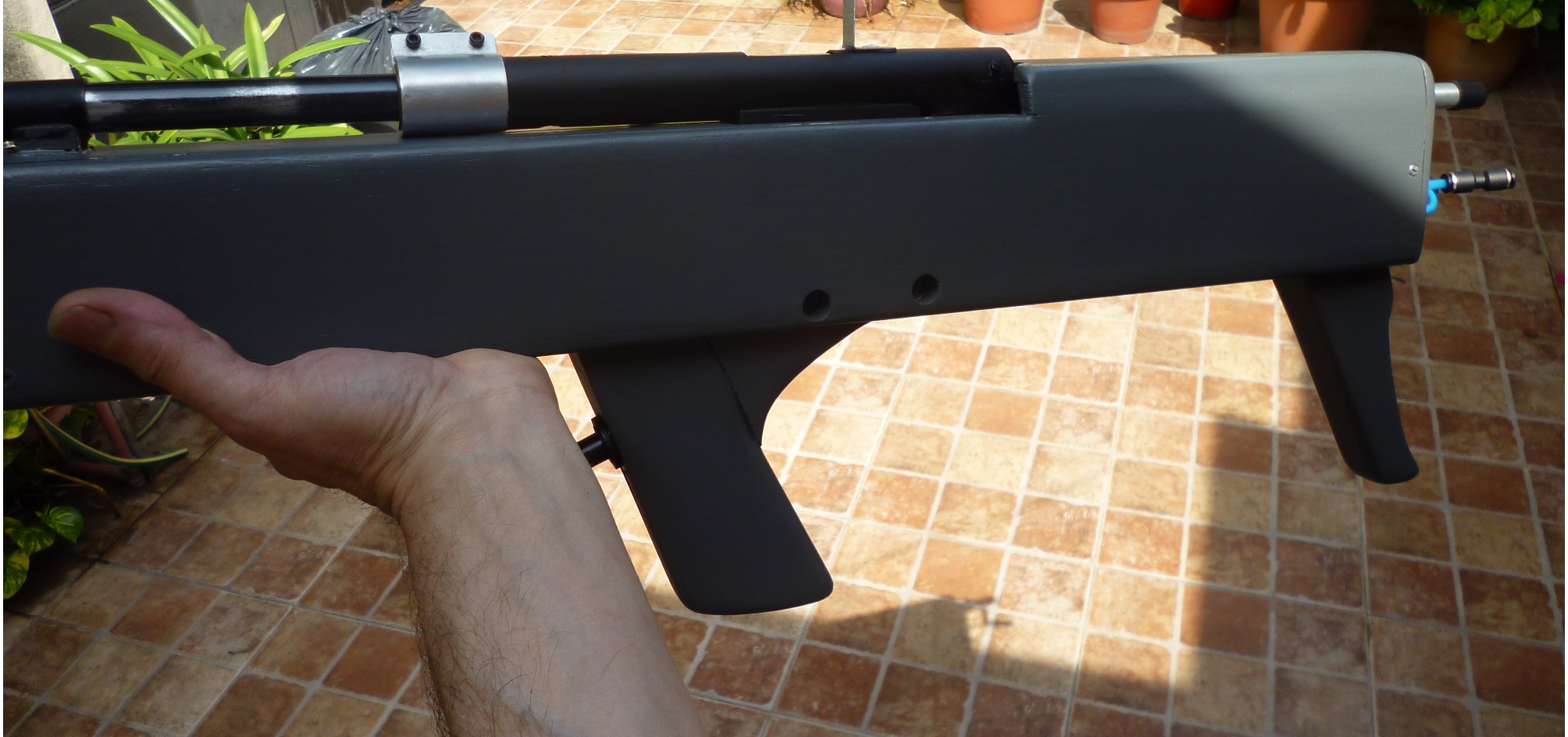

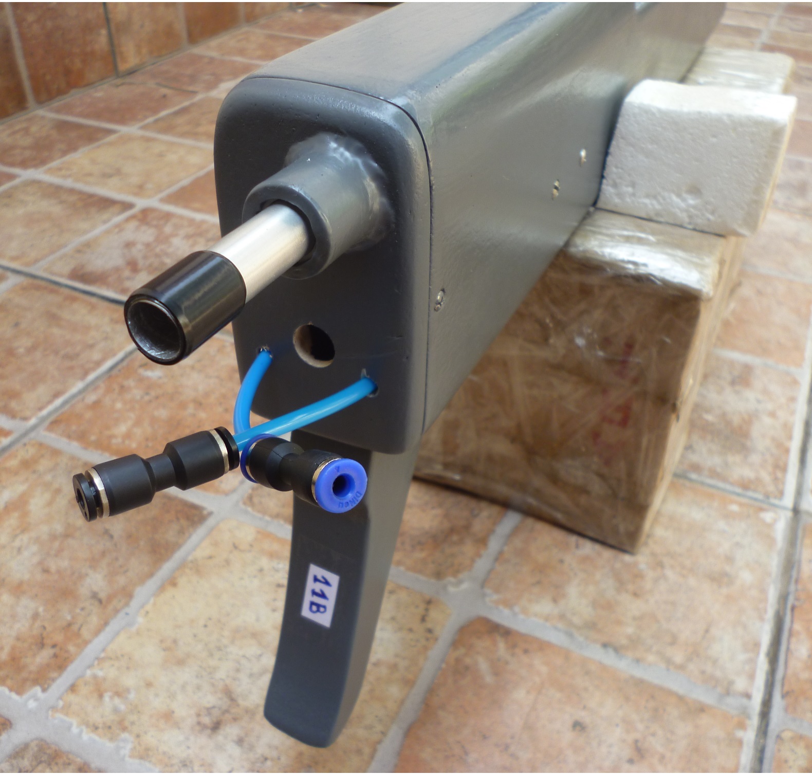

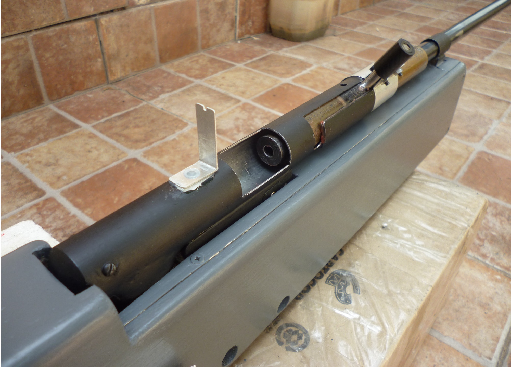

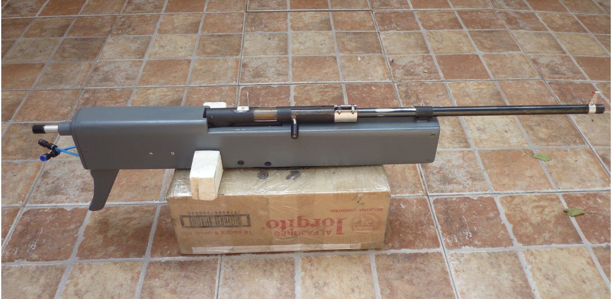

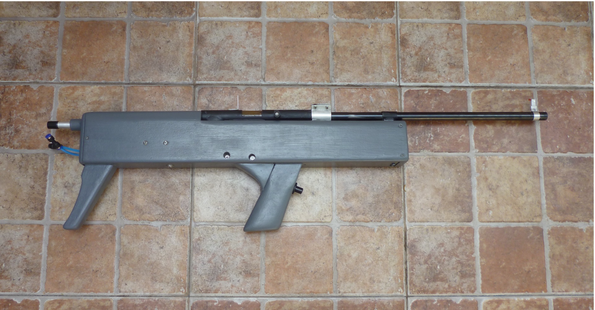

Update of this 5X hybrid prototype, .25 caliber that shoots pellet. I have built a fairing in light wood, and I have installed an open sight to aim. It works excellent. I am using it to 5X to tweak a little. In the previous photos it looks like the interior, the machine. I have replaced the dosing cylindrical tube, with 1.8 meters of 2.5 mm inner diameter hose, and that gives me the butane dose. This idea simplifies everything and it is not necessary to have to build a dispenser. Simplification works well, and the gun fires normally. If you want more gas the hose should be longer, and if you want less, shorter. It is rolled inside this weapon, the HA-V.
I am using a butane gas and air tank, remote. The air tank is charged at 150 psi, and I can fire about 25 times. The propane tank is 20 liters ne !!! A large bottle that I hope will allow you to recharge the small ones, which are installed inside my other weapons, and to play with these hybrids.
The two connectors seen on the back, coupled to the hoses, are for compressed air and butane.
The barrel is purchased, with 12 micro grooves, and 24 inches long, it is very accurate with a 22 grain pellet.
The subsequent command shown in the photo is to reload the system, and the firing system is a simple bolt. When I can I will make a video so they can see it shoot. In summary it is a very practical system, without much complications, and very regular and reliable when shooting. :)
I forgot ... (in case there is curiosity about this issue)
The number seen on the stock that rests on the shoulder, the number of pumps needed to use the system with a manual inflator. Shoot exactly the same. Just remove a bolt to remove the pneumatic actuator that opens and closes the exhaust valve of the combustion chamber.
