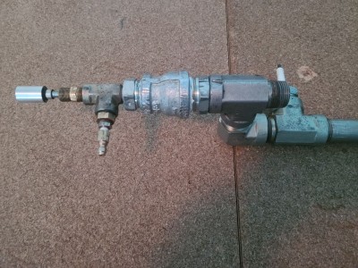

I pre pressurize the hose prior to opening the valve, that way the air forces its way in before the propane can escape.
I'm thinking that as I raise the mixture that the margins become smaller. Giving a larger window of pressure for a stoichiometric mixture?

Once the valve is open the mixture is going to go both ways.
I think you're running lean because of this, maybe experiment with a 15% greater propane pressure to compensate and see if it makes a difference.

I found I have to purge my meter pipe with propane to get the air out before fueling, otherwise the first shot will be weak and funky because the meter has an atmosphere of air in it.

Right on guys, ill keep tweaking things. I think it would be a good bet to lock the fuel regulator in position and adjust air pressure for compensation so I am only changing one variable at a time. One thing I have noticed is that tapping the fuel gauge will cause the pressure to fluctuate by .5- .75 psi. When there is no pressure it reads about 1 psi. Im starting to think I need to replace this gauge. Maybe even the regulator.

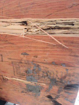

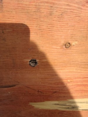

So you guys were on the money. I was lean for sure. I think higher mixes helps aswell. I have been successful up to 30x with roughly 20psi propane 420psi air. Now it seems to be on par with the phenumatic counterpart.
I do intend on mounting it on a stock or something of the sort. Like a bulpup configuration. So I rearranged the components so I'm not staring down the relief port any more.
Its alot more fun with success.

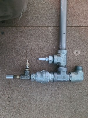

I have ran into an interesting problem... moisture from combustion is condensing in the spark gap. If I get 2 misfires in a row I pull the plug, and sure enough there is a micro droplet of water bridging the terminal. It happens quite frequently. Unfortunately if I open the gap any further the spark plug will arc from top to bottom opposed to in the chamber at 30x.
Has anyone else experienced this problem?

The same thing happens to me, sometimes. In my city, the north of Argentina, the climate is extremely humid and hot. On very high humidity days, the first shots sometimes miss. It seems that when the camera takes some temperature, the problem disappears. With my air compressor, in my workshop, it is the same. When I use it, when I finish doing it, I have to draw water through the bottom plug, and it is quite a lot. In short, shit!PracticallySane wrote: ↑Mon Dec 28, 2020 8:14 pmI have ran into an interesting problem... moisture from combustion is condensing in the spark gap. If I get 2 misfires in a row I pull the plug, and sure enough there is a micro droplet of water bridging the terminal. It happens quite frequently. Unfortunately if I open the gap any further the spark plug will arc from top to bottom opposed to in the chamber at 30x.
The solution for me is to heat the chamber, or the spark plug, a bit so that the water evaporates.

I was hoping to find a solution to avoid removing the spark plug. I am also putting some thought into a glow plug ignition instead. Trial and error...
I was even debating placing a "silicon desiccant pouch" in the chamber to absorb excess moisture.. I figured it would end up fired out the barrel so I have not messed with that yet.

You may be able to direct the air - mixture inlet towards the spark plug contacts. A little air with some speed might do the trick. My combustion chambers are no more than 10 cm3, and I have the gas inlet stuck to the spark plug contacts. Matter of testing.

That is a very good idea! Not bad at all, I think I will give that some kind of effort. Many thanks.

There are commercially available solutions that you can attach to your pump: https://www.pyramydair.com/s/a/Hill_Scr ... kring/1141PracticallySane wrote: ↑Wed Dec 30, 2020 8:28 amI was even debating placing a "silicon desiccant pouch" in the chamber to absorb excess moisture.. I figured it would end up fired out the barrel so I have not messed with that yet.
Failing that it should be relatively easy to make an inline filter containing some desiccant.
