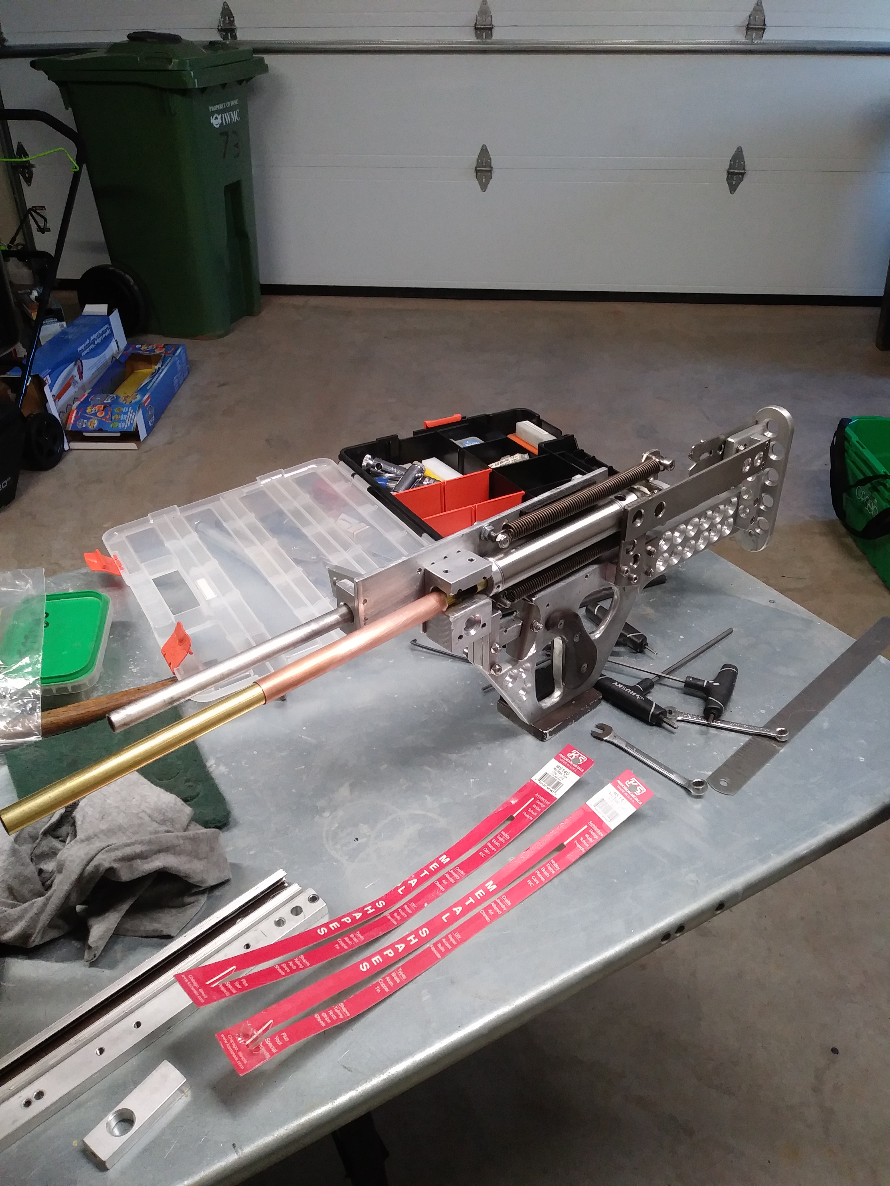

In the process of converting my airsoft spring powered to nerf darts, it will still be able to fire airsoft with a barrel insert. Inner barrel is 17/32" K&S brass tubing with 9/16" sliding over that and 1/2" plumbing copper over that, all a perfect fit. First test fire show this has some power, way more than my CedaS it seems, going to get my homemade chrono hooked up again when it's finished. Also added some Drillium.

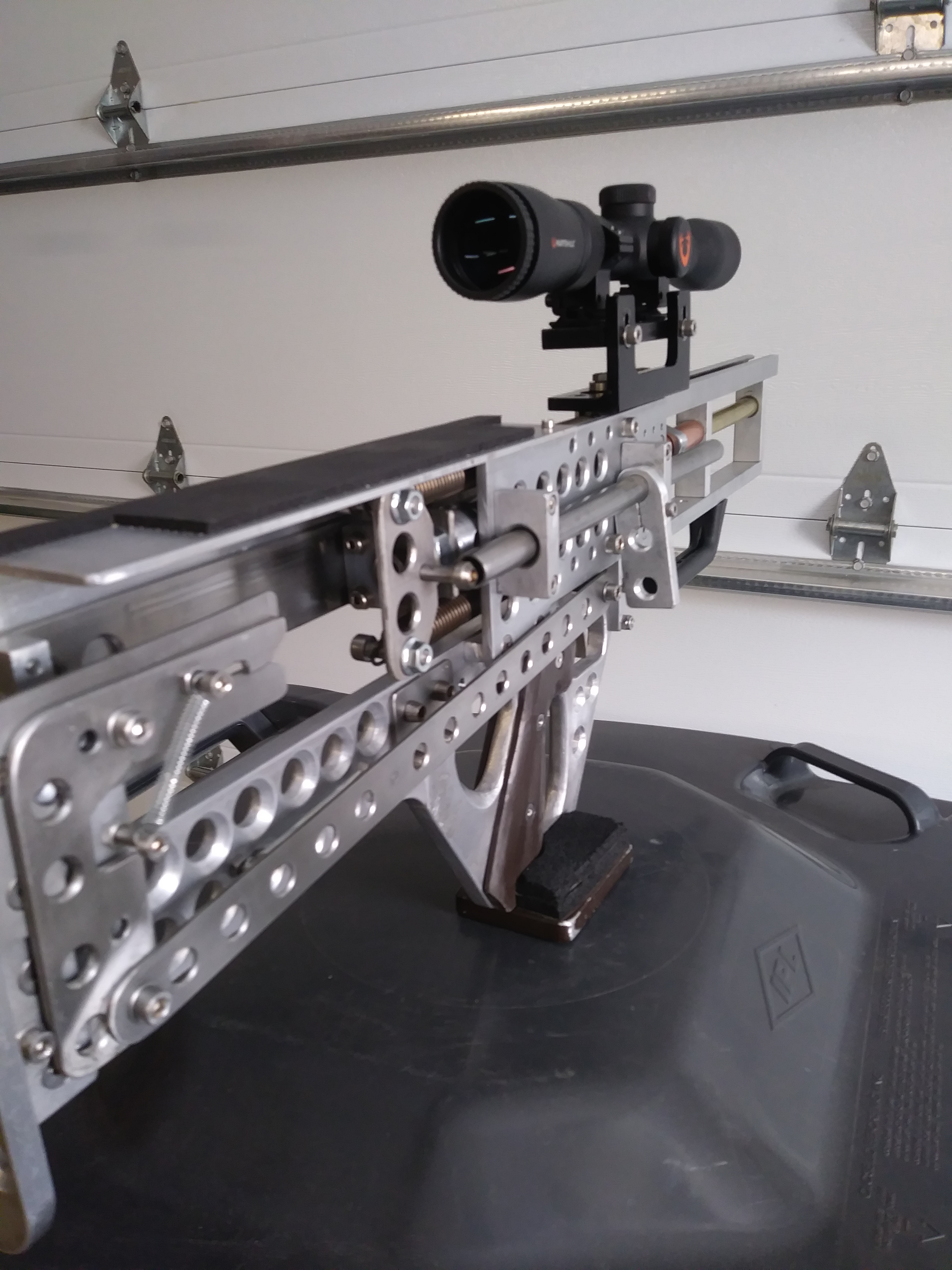

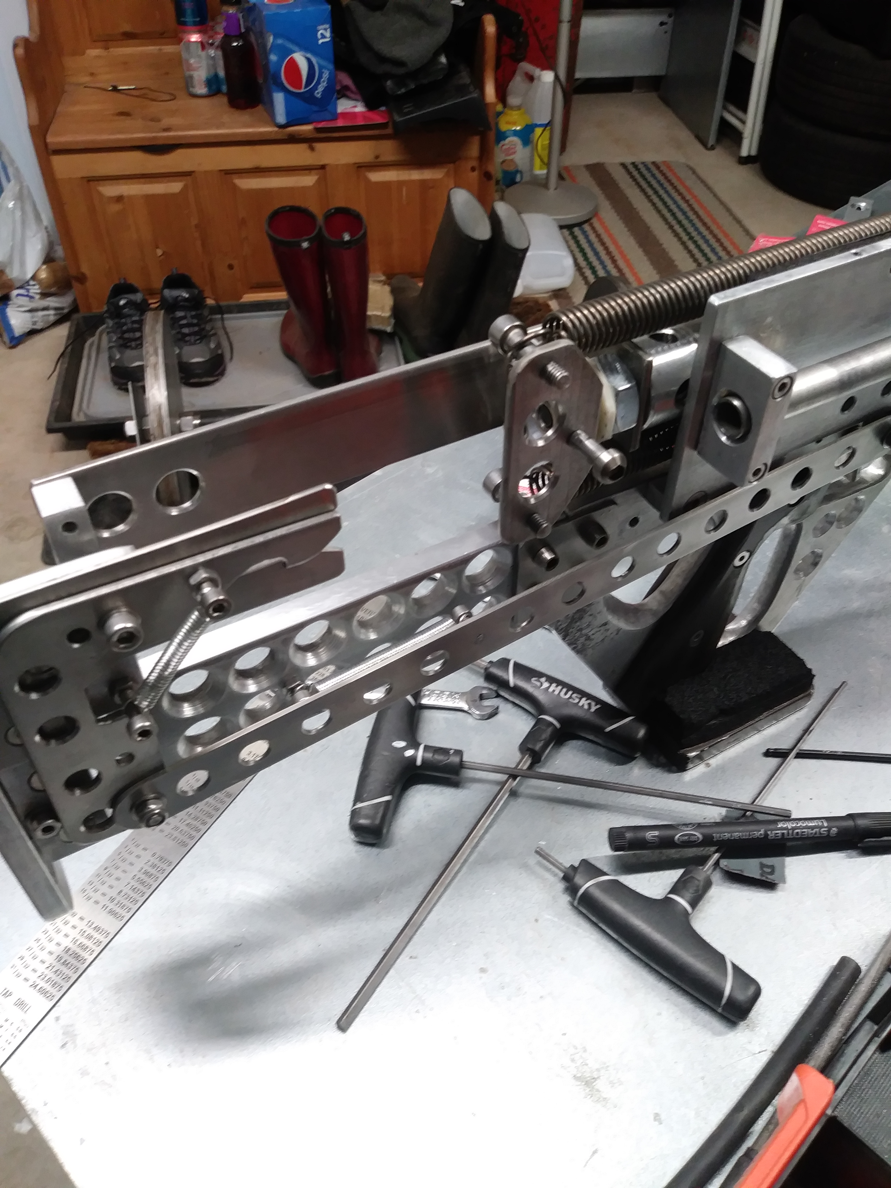

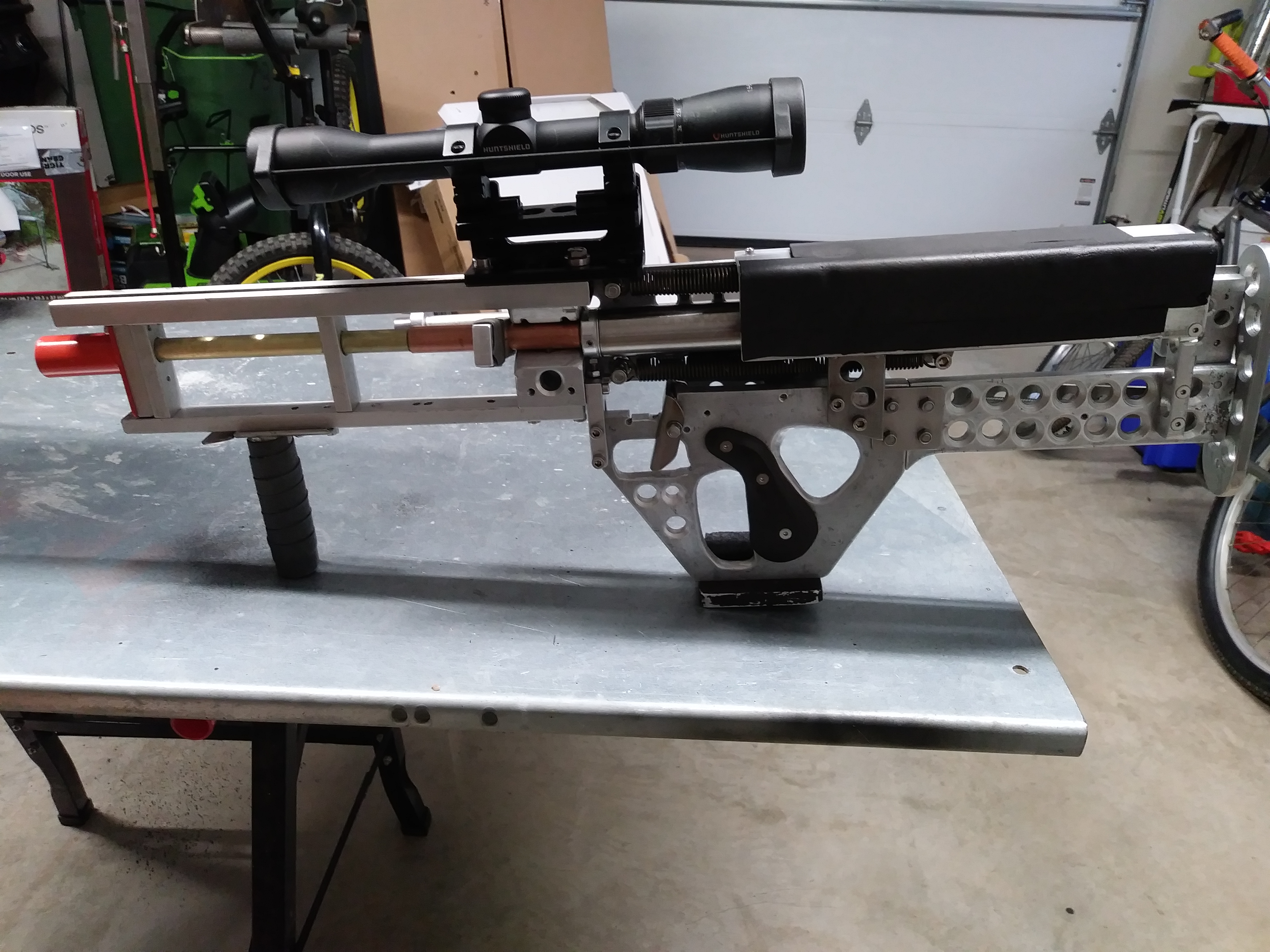

Sun Apr 04, 2021 4:57 pm
The airsoft barrel slides inside the Nerf barrel and clamps at the front, changed the front grip and the charge handle again. Orange muzzle.
Will put a foam dart into single layer corrugated cardboard.
