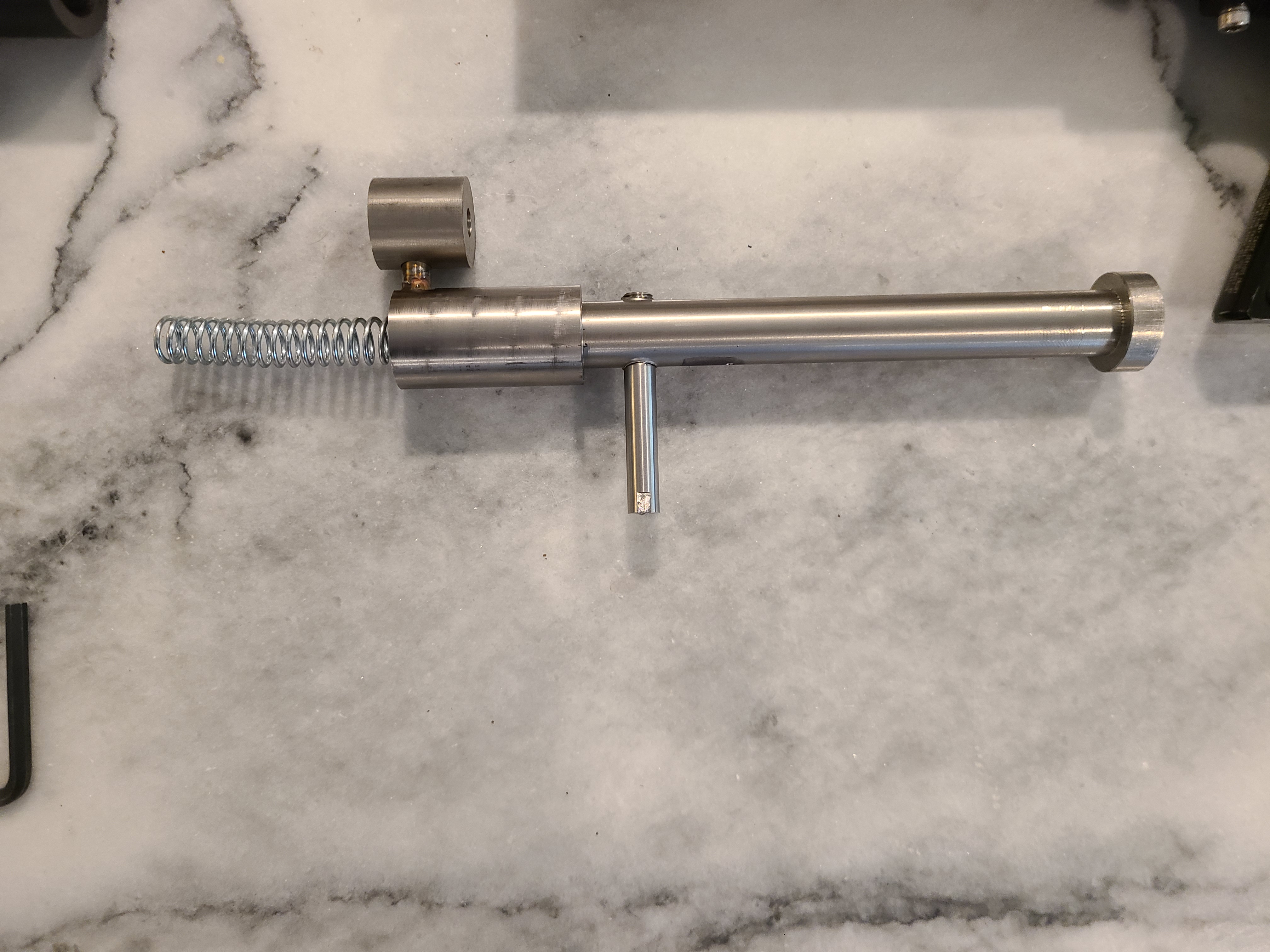

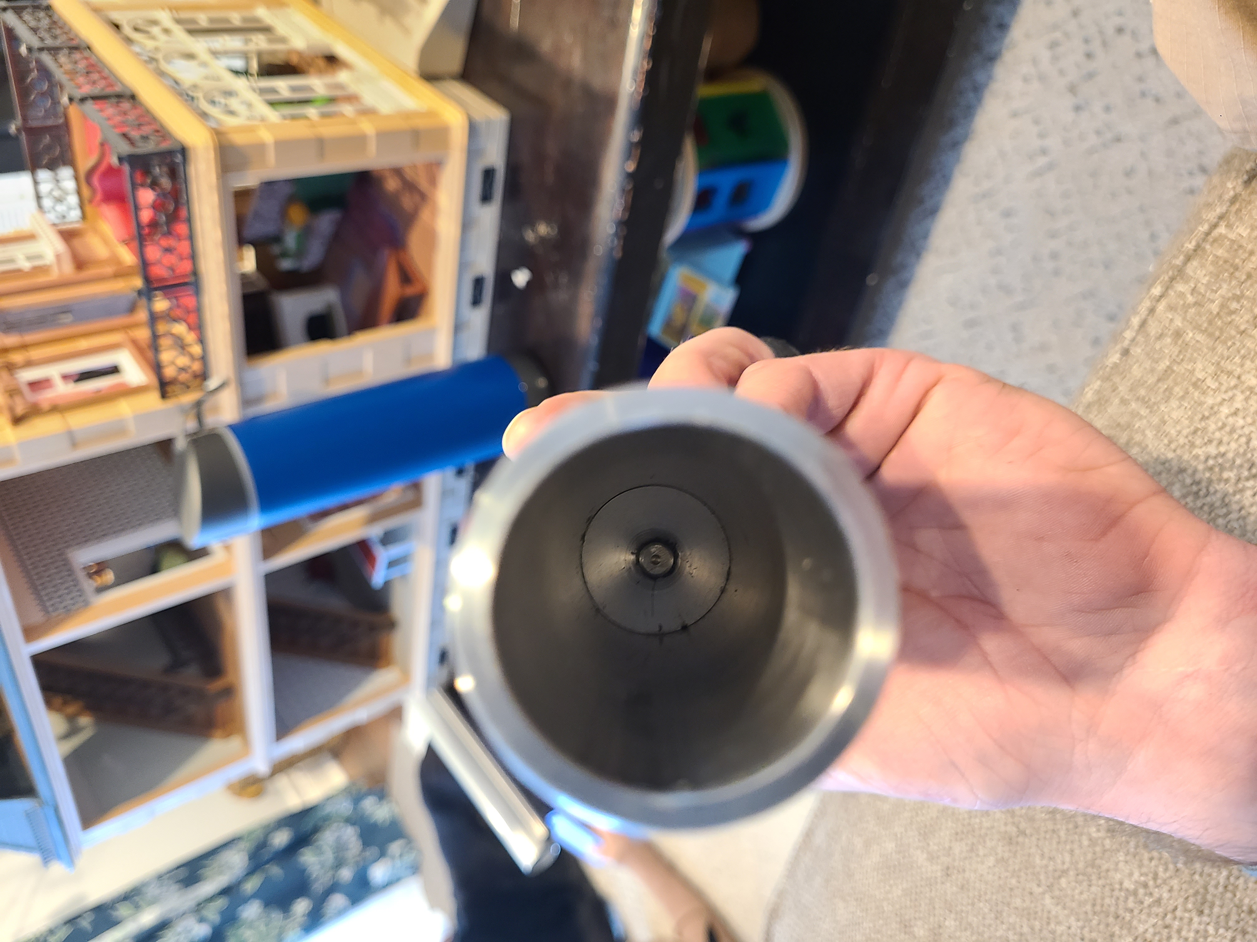

shown below is the valve assembly. The valve is composed of a hammer-needle style valve which actuates the Toolie piston. In total, I'd estimate around 2.5in^3. This was build mostly out of 303 Stainless on my lathe. The sealing faces in the picture are made of brass, which worked great for about 30 shots, but then became problematic (likely due to dust/contaminants). I rebuild the sealing faces out of Delrin, which has worked consistently.

Below you can see the rear of the pin from the hammer-valve.
Below shows the business end of the valve

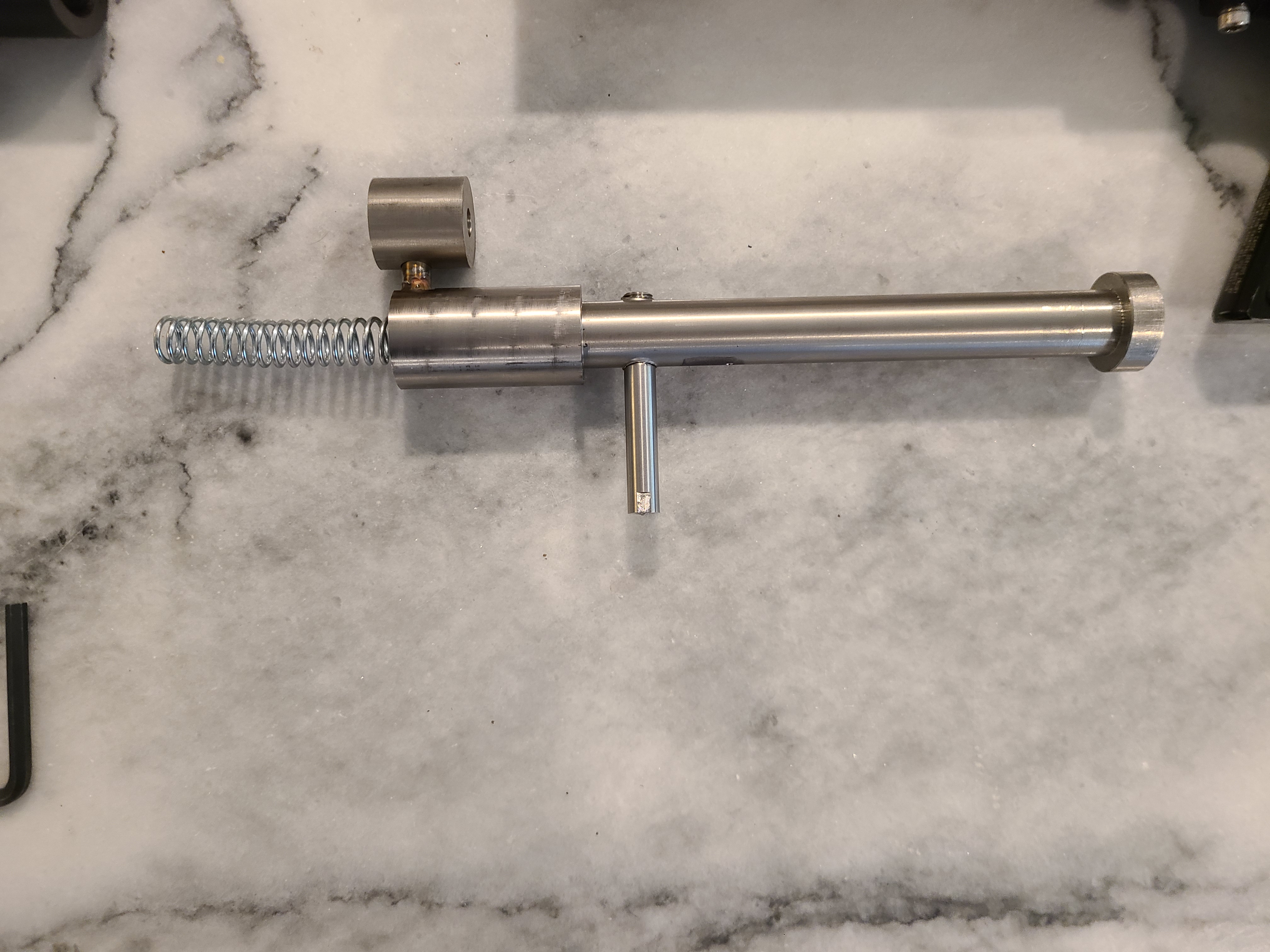

Below shows the hammer which is mounted in the lower tube of the rifle. I wanted to have as long of a barrel as possible, and didn't want the air to have to work its' way around corners, so this configuration seemed the best. The top piece of steel is what actually makes contact with the pin on the hammer-valve. This was measured to just barely open the valve to its' maximum depth without smashing it into the Piston on the other side. The lower portion of these pictures show the hammers larger mass, as well as the face that presses against the sear.

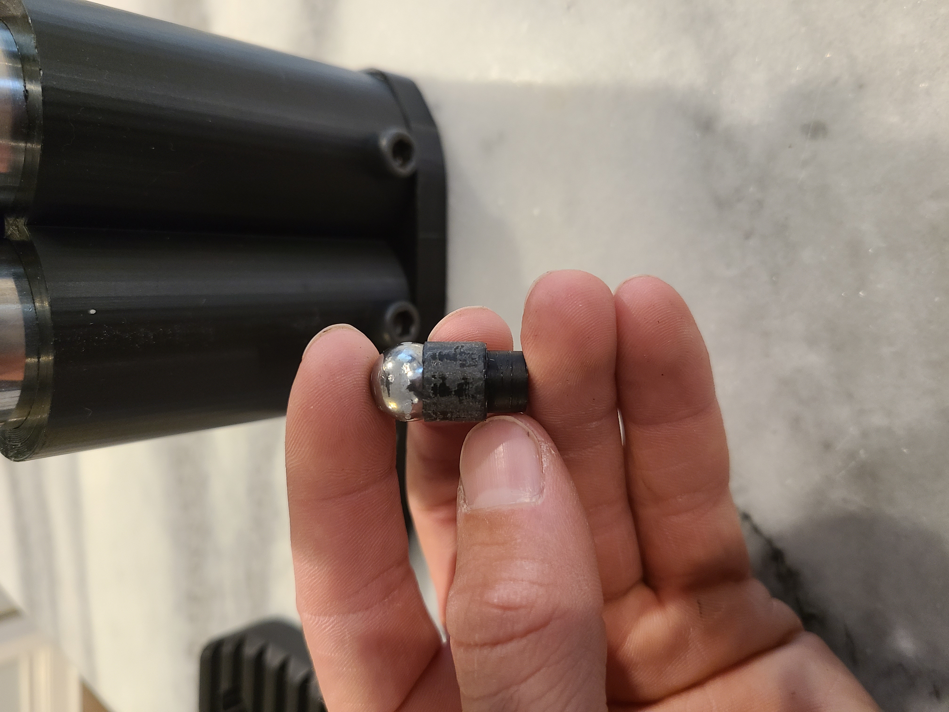

Here is the primary ammunition I shoot. 3d printed Sabot, with a spherical opening in the top for a 1/2" ball bearing to be glued in. Extremely cheap for what it is. Note the rear end has a small protrusion. This protrusion fits as closely to the valve face as possible, to avoid dead space.
