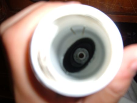

Now I will tell you how to build a mini spud gun like mine. First you will need:
• 2 pen tubes(keep the ink holder for a loader)
• a camera film canister
• a 4 inch pill bottle with cap on
• long nose lighter igniter (lighter disassembly here http://www.advancedspuds.com/lighter.htm)
• 2 thumb tacks
• duct tape or electrical tape
• Axe or other aerosol propellants like static guard, hairspray, etc.
• potatoes
First take the film canister and cut out a hole in the center about 1 cm. round. Then take the two pen tubes and tape them together really tight. Then take a long strip of tape and rip it in half. Wrap the tape around the end of the pen tubes until it fits into the hole you made. Stick that into the hole you made so half the tape is still sticking out. Then take a whole piece of tape and wrap it around from the top of the film canister over the tape to the pen tube. Then make an oval shaped hole in the pill bottle that fits the film canister (if you have to wrap some tape around the canister). Then tape the canister to the pill bottle. Now it's time to install the igniter. For disassembly instructions look above. After you have the igniter, wrap the end of the wires around the thumb tacks. Push the thumb tacks into the bottle at an angle so that there are space in-between them.
Now tape the igniter to the bottle so the pusher part is facing the cap. Tape the wires down to the bottle and you are done. Now all you have to do is load in a potato, load it down as far as it can go with the ink holder, spray a tiny bit of aerosol in it and fire! Do not spray a lot in it or it will not fire. If it doesn’t fire open the cap, blow in it very softly for a split second and recap it. Wait another 5 secs. and fire. Repeat process until gun fires.[img]
