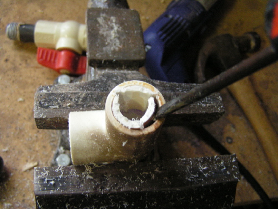

All you need to do is cut about 4 vertical slices in the pipe/fitting attached to the pipe/fitting you want to save. Then with a hammer and a screwdriver(a small chisel works best but a flathead screwdriver works), you work the screwdriver between the two parts and pry. I suggest that you work the screwdriver in on several spots for each slice before prying. If you do this correctly the solvent weld will break like a hot knife cutting through butter............well, not exactly like a hot knife but you get the idea.

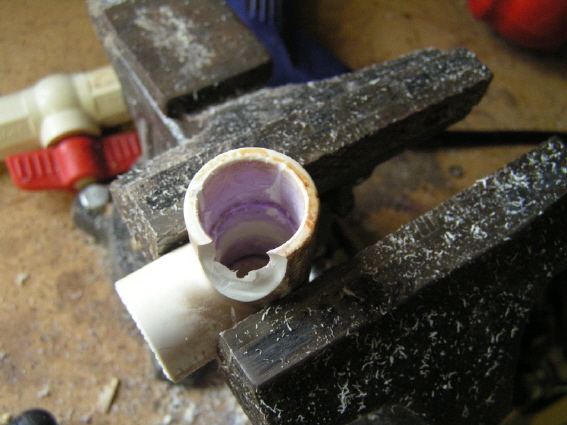

Here's the removed pieces.  The one on the far left is the small piece that broke off of the fitting.  Don't know why I took a picture of that.
Here is the piece with all the pipe removed.  Remember, this only broke because it is old, burnt, and small.  The fitting doesn't brake under normal circumstances.  Next time I have to remove a large fitting I'll get a picture of that.
A picture of me prying it with the screwdriver.  Just remember to work it around with a hammer first, then pry.
This is the fitting with the vertical slits cut into it.  Since it's small I only made 3 slits.  I used a dremel to do this, but you could also use a hacksaw, knife, etc.
