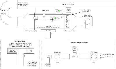

Your setup sounds good. Keep in mind, you should not use oxygen enriched mixtures in normal sch40 (let alone DWV) pipe. If you intend to burn oxygen enriched mixtures, you really should opt for sch80. At the very least, make sure your pipe and fittings are all NSF-PW rated.
You may have issues using one meter pipe for both gases, but it can definitely be done. One thing I don't like about that design is that you're containing a pressurized, stoichiometric mix of propane/oxygen in a pipe - if it were somehow to ignite (static, indrect heat, etc...) this would become a bomb.
Assuming it's not out of budget, I'd just run two meter pipes. You could connect them to the chamber with one hole via a T. They could even be made of PVC to save money.
Unfortunately, you'll still need to vent your chamber, because of the spent exhaust gases from the previous shot. There's really no way around this.
You could put a ball valve on the back end of the chamber instead of a clean out cap, which allows for quick venting. But if you do this, make sure you leave some way to access the chamber in case of repairs. Some people go so far as to put a check valve and mattress inflater on their chamber for automatic venting.
I like the remote detonation idea using a stungun. Should work beautifully.
Keep in mind, a fan does help to mix the gases together, and vent the chamber. The "wires" problem really isn't a very big one, you're only talking about two wires. Put them through a very small hole where a pipe and fitting overlap, and epoxy any space around the wires. Simple and safe. This is just my opinion, though.
Attached is a quick drawing of the design I'm working on now. You could add a second meter pipe for oxygen and attach both meters with a T. Also attached is a set of Excel spreadsheets called the ProMeter Suite (in a zip file, I promise it's virus free). The sheet called ProMeterOX gives you proper propane and oxygen meter pipe sizes for a given chamber size. Hope these are helpful to you.
Good luck. Let me know if there's any other questions I can answer.
Peace,
Pete Zaria.
