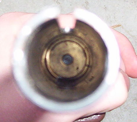

Wed Jan 31, 2007 6:11 pm
Here's some pics.
hammer and main tube
I think this notch is what is holding the valve in.
looking down the tube at the part of the valve that is hit.
The valve outlet.
The valve outlet.

Wed Jan 31, 2007 7:18 pm
I say make a saddle tee.

LGM, I hate to burst your bubble but unless you can generate about 1000psi that valve’s going to be next to useless. Pump-pneumatic air guns generate as much as 2000psi, if you used the pump tube that would be a different story. What caliber are you going for?

LGM, the valve is the chamber. And DON’T USE Co2! You could screw up the valve.
What are you trying to make, what caliber? And airgun valves are designed for a specific task, i.e. shooting .117 or .22 caliber BBs and/or pellets.
What gun is you valve from (make and model)?
At the moment I am holding the valve out of a Daisy Power Line 856, valves like this are useless for any thing other than an airgun, and there not vary good at that job ether.
