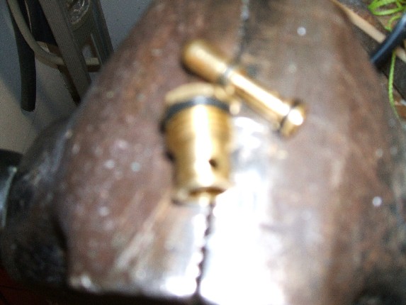

Part 1: Modifying the blowgun<br />A regular Husky blowgun.

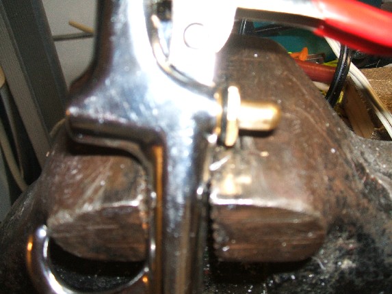

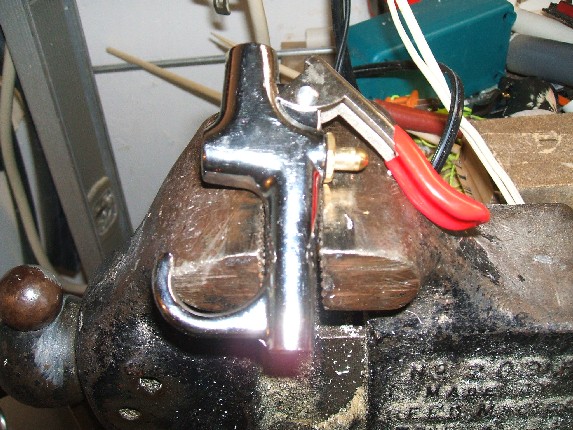

Unscrew the internals.
Take out everything but the spring.

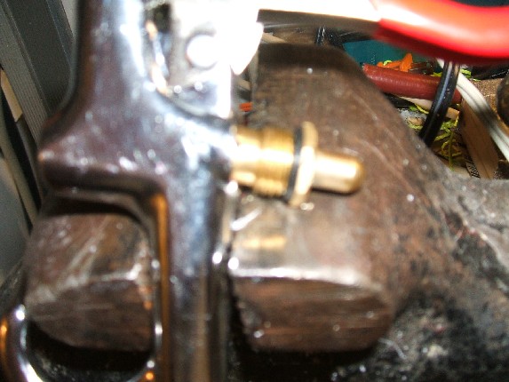

The internals.
The internals.
The inside parts look like one, but they're two pieces.

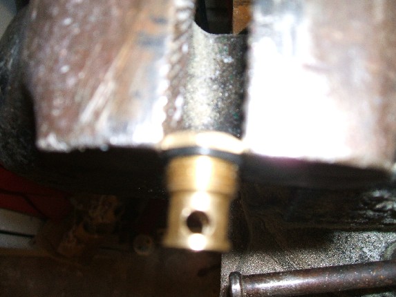

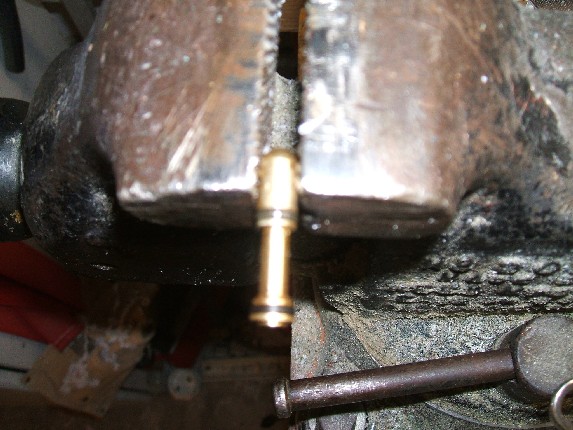

The starting bolt.
The starting bolt.
The finished bolt should be about half the width of what there was to begin with.

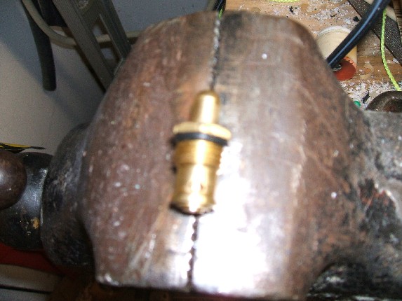

The starting hole was smaller than a .177 BB.<br />The finished one is over 1/4.” Now put everything back together.

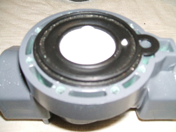

Part 2: Modifying the diaphragm<br />The “regular” version.

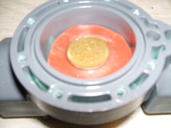

The new version, capable of 175 psi, with loads more flow.
The diaphragm is made from 1/8” sheet rubber, and a steel token slightly smaller than the spring, so the diaphragm is aligned.
TIM 013.jpg (14.36 KiB) Viewed 11780 times

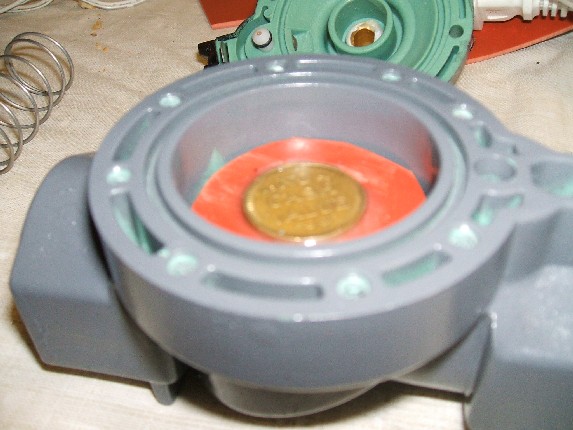

Another shot of the new version.

How'd the picture of the new diaphragm get up there? :lol:

very nice job, however, it seems that the new diaphragm is in a different place(lower down) than the original, so how exactly does it work?
is the metal peice on the new diaphragm a coin?
noname
Posts: 2698
Location: Bay Area, CA
Wed Mar 28, 2007 11:11 pm
It is lower down, which means it moves up, allowing an assload more air through at once. It's like a really high flow QEV, except 8 bucks cheaper and inline.
The metal piece is indeed a coin, a token to be exact. It's thick steel and fit right into the spring, so I used it.
A-98
Posts: 921
Location: Santa Barbara, CA
Wed Mar 28, 2007 11:14 pm
OH! i see how it works now. silly me :oops:

Do you have to drill out the blow gun? Thats really cool, im going to do that to mine.

You can, you'll get much better flow.

i cant really see what you did to the blow gun did you just sand it down so the diameter is smaller?

lukemc, use a fine file to file it down to about half the original width.
mopherman, where the solenoid was, there is a circle of rubber. Peel it up, then peull hard to get the diaphragm out.
I forgot to mention this:
To anyone who is using this mod, the first time I tried a valve like this, it leaked like hell out the sides. All you need is an O-ring to fit into the circular groove that the diaphragm's edge was set into.
