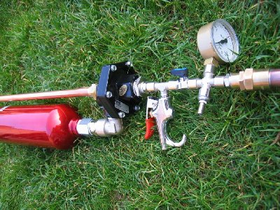

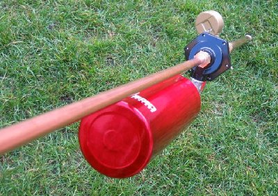

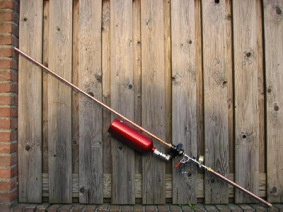

1.5L aluminum chamber.
QEV slightly modified.

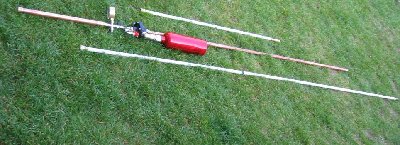

6feet 3/4" as main barrel, definitely packs the biggest punch energy wise. I also have 3.5feet and 8feet 1/2" barrels, I only shot the 8feet barrel twice since I haven't got a breech loading system yet nor an 8feet ramrod.
The small ball valve is to minimize the pilot volume before firing and makes it possible to disconnect the pump without triggering the gun.

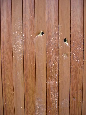

At the moment I mainly fire spuds. Batteries or cylindrical bearings at close range if I want damage. And my own home made projectiles made by making an arrow out of soda bottle labels with a screw in the tip

-Damage pics
