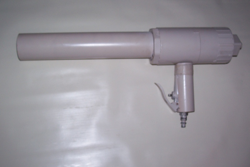

this is my first .177 cal cloud. used bb gun rifle barrel. it shot fairly good but i have decided to build a inline vortex block for it out of aluminum. i wanted the gun to resemble a mac 10 but i havent made sights for it yet.
http://www.freewebs.com/spuddin
btw i used up 4000 bb's that saturday, i used a magnet to pick up most so i could reuse them but of course u never find alot of ricochets so the bb's eventually run out.

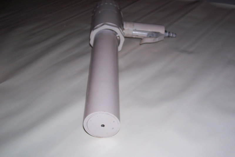

notice the eerie ghost image under the barrel!

That's a cool looking gun, but what did you use for the barrel?

i took apart a broke bb gun rifle and used the barrel from it.

I know your planning on makng a vortex block, but an easy way to increase ROF and power would be to make the chamber smaller. I use 1.25" for all my chambers, except for my most recent cloud, which uses a longer 1" SDR 21 chamber.

that looks sweet and giving it a vortex block would rock
great gun :D

nice gun you have there!
