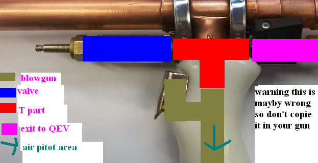

@Squad-cog - no, there is actually a T with a air filling valve and a blowgun on each side - you fill the cannon with from one and fire it with the other.

@ Hotwired - but your gun has only a blow gun.
Or is that blow gun in this case also the filling valve?

In the below picture the blowgun can be seen coming down but there is the filling valve after it. Thats because there is a T fitting in there.

Hotwired wrote:In the below picture the blowgun can be seen coming down but there is the filling valve after it. Thats because there is a T fitting in there.

like this???
