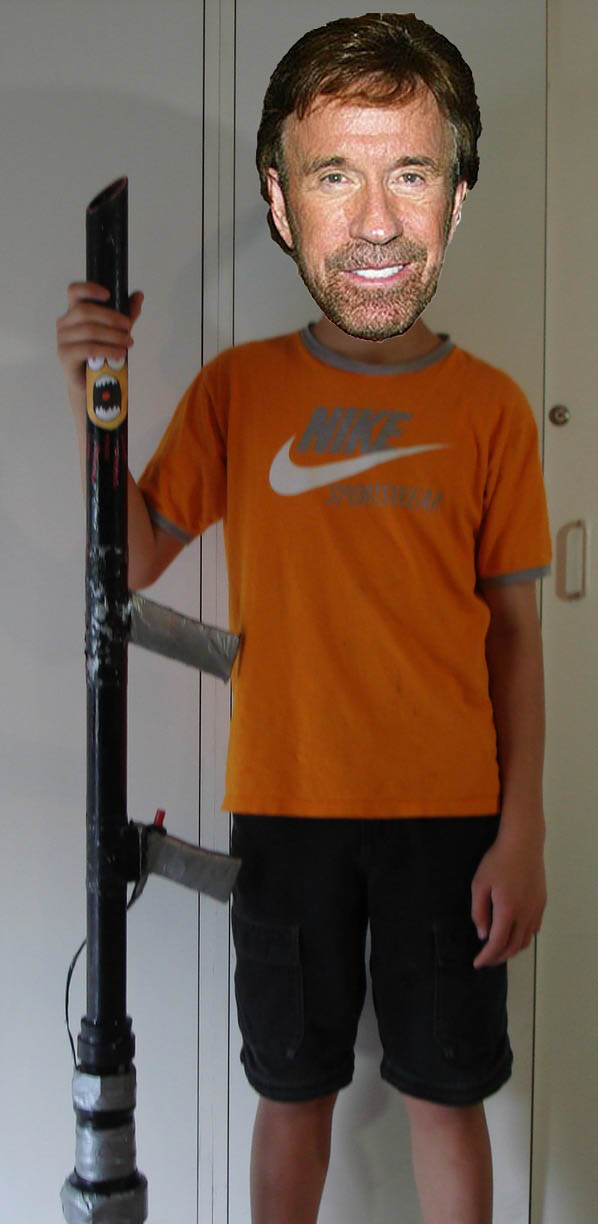

Here is a upright pic of the redone gun. Chuck to the rescue!
