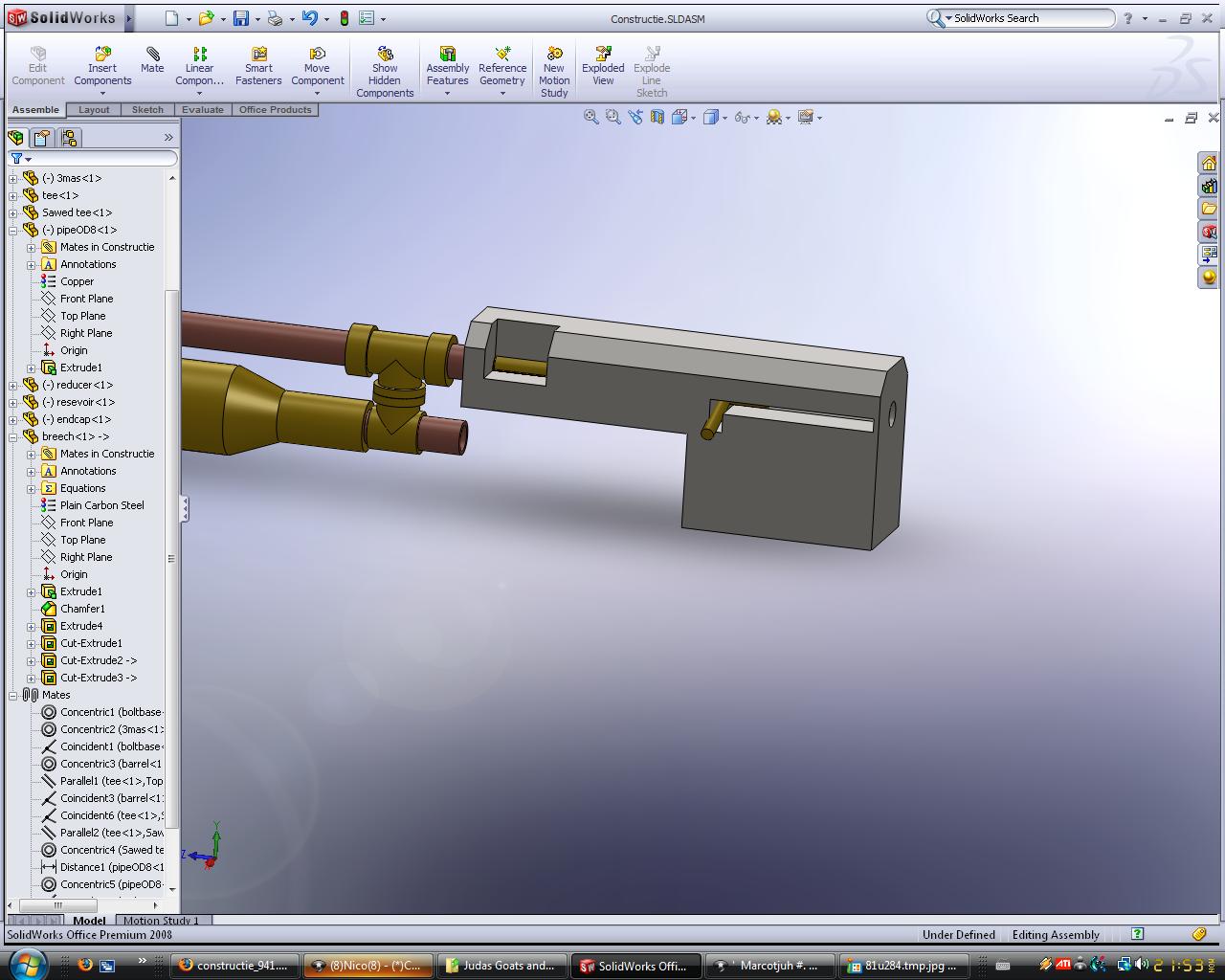

Making some more progress...
Merged:
That stacked valve looks sweet.
To the drawing board! (wich is the pc so i don't really have to move..)

Making more and more progress.. :D
Solidworks is the program.

Mr. Beaver wrote:off topic- what is this program you are using exactly???
LoooL, if you open the picture it says solidworks at the topleft. You cant miss that. Btw Necrosis Nice gun design, looks great.

Making a photorealistic render takes a few dozens of hours of computing alone :wink:

that solidworks thing looks pretty cool, it must take a while to put in all the fittings and stuff though.. and btw your design looks pretty cool :)

Necrosis: What are you going to use for the valve?
You might see if you can find a junked washing machine and steel the water inlet control valve(s) from it. You might also look for the water control valve from a dishwasher or Frig ice maker.
I made a BBMG with this type of valve;
I got mine from a surplus place, it is an electrically activated diaphram valve. I paid $4.50.
The throat (3/8") is too small for a typical spudgun but more than big enough for a BB gun.
Using 36" of 1/4" brake line it'll launch multiple 0.17" BBs at ~350 FPS. With a better barrel, or an actual chamber, it'll probably do a lot better.

Yeah, I have access to a lathe though, so I will actually make a condor style valve now, inline in stead of under.
ooh a hammer valve good luck with it i'm looking foreward to seeing the finished product already :D
