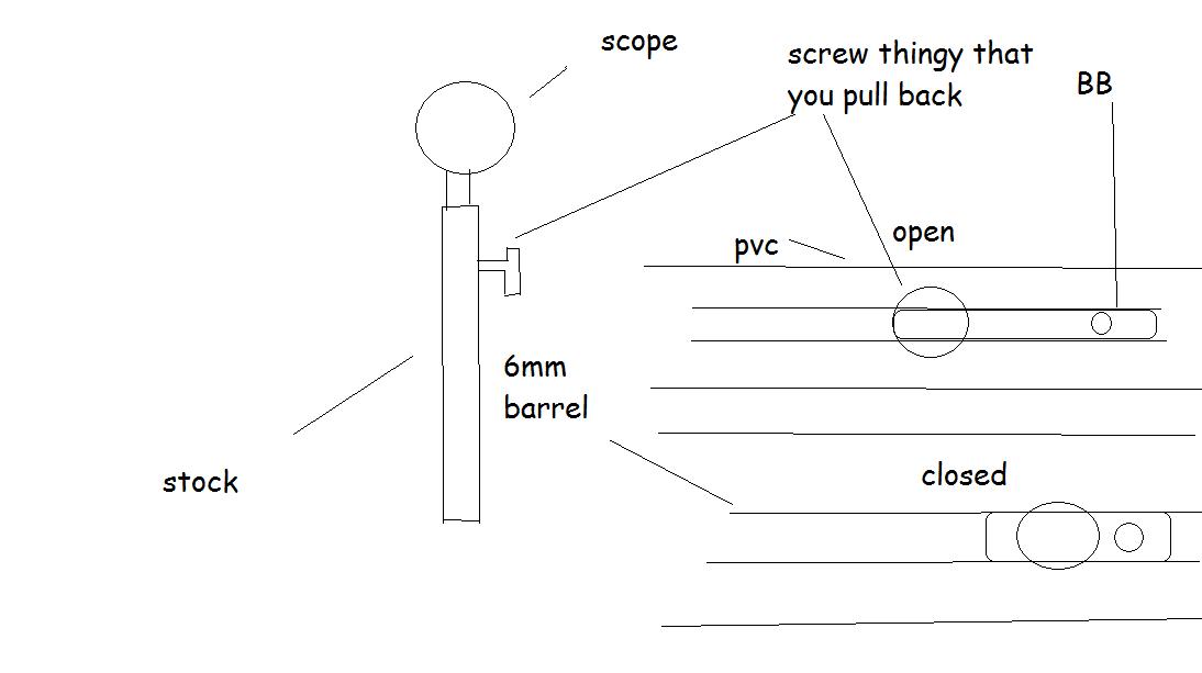

I've been looking around and came up with this simple design. It's not that original but it will be my first homemade airsoft rifle. Comments Appreciated.
MAKE SURE TO VIEW IN FULLSCREEN
sorry about bad quality i did these with a touch pad. If they're hard to understand please leave reply and i will clarify them.

I don't really see anything wrong except your bolt needs to be a piece of pipe that slides in your barrel but lets the air through.
In your design the air will just smack the bolt forward and push the bb, with some more thought you could make a compression chamber and basically have a permanently semi auto airsoft gun.
Although I think what your trying to get at is the former option... Make sure you put in a bolt locking mechanism probably just a little right angle the bolt sits in while loaded.

jonnyboy made some good points. I thought airsoft bb's were 7 mm in diameter, there for needing a barrel bigger then 6mm. 8mm = 5/16th's of an inch, 5/16th's brake line should work good for a barrel. Something to think about.

It is a bit unclear to me how your bolt mechanism works.
Is it manual bolt action?
If so, then you should make sure the bolt can be locked down.
That is an understatement my friend.
@Kevintheguncrazy
Consider spending more time on your diagrams. If we can't understand them, we can't help you. Look at some of the paint diagrams JSR has put up. He does a great job in making them clear and understandable. If you are going to spend as much time making this gun as (i think) you spent on the diagram, It won't turn out very well. Take your time and be patient.

Thanks for tips and once again the design was hard to make using a touch pad.By the way it is going to be a manual bolt action rifle.

How are you going to get bb's in the barrel? My terminology isn't great, so do you mean manually loaded? because i've tried that after loosing my magazine, and it's as fiddley as a rude word begining in "F", so even a gravity fed magazine would probably be better (that could be added easy enough)
