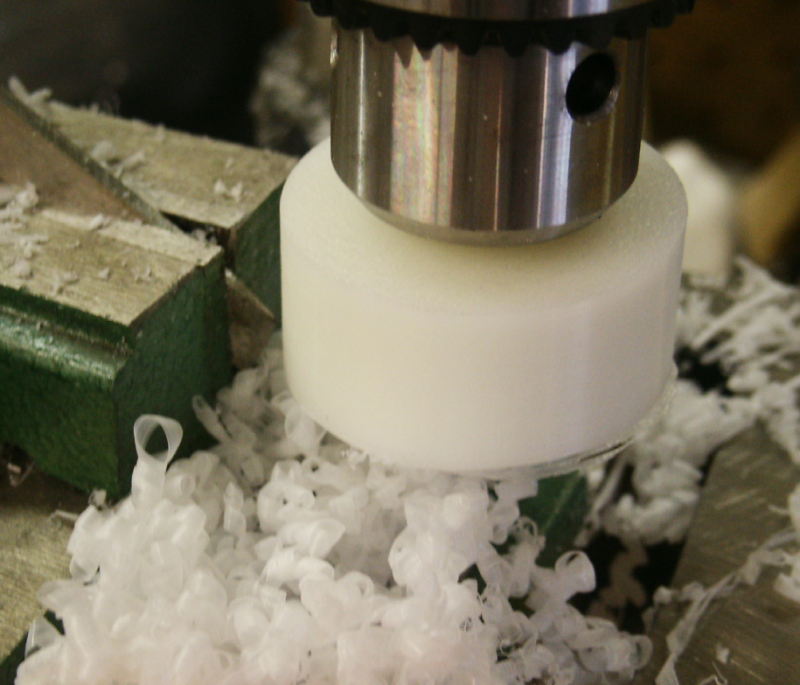

- Technician1002
- Posts: 5189
I can't possibly think of a lathe that is worth it's salt in the budget mentioned.
A good drill press with a good drill vise can be used for machining some simple parts and can be purchased within budget. I cut my pistons on a drill press.
Think on spending a couple hundred on a really good drill press and another hundred on a reasonable drill press vise to hold machining tools. An X-Y vise is worth the investment.
Micro lathes are good for clock makers and are powered about as well as a key cutting machine. They are unable to turn large pieces of steel at proper cutting speed. Steel has a cutting speed. Micro lathes can't do it on stuff larger than about 1/2 inch. Ok i guess if you are making BBMG's but not bigger stuff.Now I have heard about micro lathes and seen a few that are very cheep and seem to be fairly accurate. what sort of price range am I facing if I want a good quality small lathe that will let me drill strait holes into alumium and otherwise work with metal?

- Get one like this as a sub for a lathe
- Vise.gif (8.34 KiB) Viewed 5150 times

Hand held on a tool rest is ok for decorative woodwork, but not for precision piston faces. The vise is the tool stock when using a drill press to machine pistons and pop off valves, hammer valves, etc.mark.f wrote:Hmmm... I doubt it would be too difficult to kludge up some sort of simple three or four jaw chuck for turning operations on a drill press. Maybe a 3 or 4" pipe cap (steel of course) with 3/4"-10 threaded rod (or some large acme rod if you want to get fancy) going through it, and some lock nuts.

Maybe my lack of skill is showing, but this size fit is hard to achieve on a wood lathe. The valve doesn't stick and uses no o rings.mark.f wrote:Take a look at LaunchPotatoes. Every component is made on a wood lathe.Technician wrote:Hand held on a tool rest is ok for decorative woodwork, but not for precision piston faces. The vise is the tool stock when using a drill press to machine pistons and pop off valves, hammer valves, etc.
