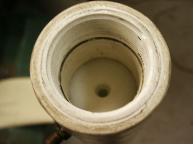

Maybe my lack of skill is showing, but this size fit is hard to achieve on a wood lathe. The valve doesn't stick and uses no o rings.
A decent small lathe for making small metal parts (small parts) would be in this price range.
http://www.amazon.com/gp/product/B001R23SAO
Mouse musket valve in place
