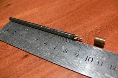

had a couple bits of small pipe and thought i would try make a mini pen gun
barrel=75mm x 2.5mm
camber=4.5mm x 70mm
full length=90mm
piston= solid rubber
valve=high flow schrader core
pressure=400psi
other=O-ring for sealing to the custom adapter to shock pump
mini pen gun

That is an excellent idea, using the schraeder core like that, the whole thing looks great, clean
What pressure have you gotten it up to?
How is it held together? I'd guess epoxy

thank you, ok so iv taken it to 400psi and yes it just held together with epoxy, as for the putting it in a sharpie its a good idea im just not sure how i would do it and still be able to fire it and still fill it, but ill look into it a bit more and see what i can come up with
