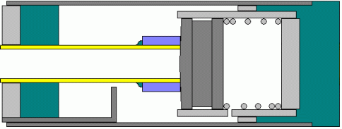

unless you need the mix pressure behind the. piston why not fill from the barrel? could make it a bit smaller.
Wed Mar 16, 2011 5:28 am
-_- wrote:unless you need the mix pressure behind the. piston why not fill from the barrel? could make it a bit smaller.
This is just a prototype but if I were to use it as a cartridge I'd probably make it like this and use the fill rig to charge it:

Agh, I think it's about time I built some of these. :) Although I think I'd stick with burst disks instead of fiddling around with detents and pistons.
One thing I can see is that power might be a little lower for these piston prototypes compared to a similar sized burst disk or detent. Since the only thing adding to the force sealing the piston is that spring, the cracking pressure will be relatively low (again, compared to a burst disk or detent), allowing combustion gases to escape at lower pressures. Not going off firsthand experience here, just did some playing around in HGDT.
But don't get me wrong, they'll still pack a good punch. The spark gap placement is also more ideal than the earlier prototypes.
True, depending on the strength of your spring. I like th idea of the piston shutting off the flow in terms of noise suppression though.

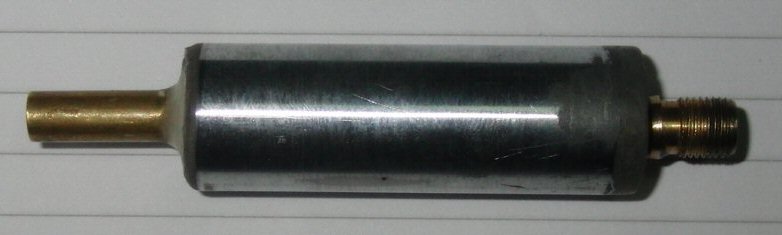

As to the prototype (illustrated below), it worked as a coaxial pneumatic at 150 psi but when I was going to try it out as a hybrid it started to leak, typical. Sleeved it in 3/4" PVC and added moar epoxy, testing tomorrow.
In the meantime I'm making a bigger full rig that will allow me to fill cartidges up to 1" O/D.

Where does it leak?
Wed Mar 16, 2011 2:53 pm
Labtecpower wrote:BOOOOOOOOOOO!!!!
Now I have to wait another day to see the results!
Damn, my turn now :D
Have a whip round, start a "buy JSR a CNC lathe" fund and your wait will be greatly reduced :)
Where does it leak?
Where they usually do - the back end ;)
Usual story, not enough depth of adhesive.

I think the major reason for the leak on the back end is due to voids in your spark gap electrode.
If you get a chance, try an electrode like I mentioned in one of the pictorials I did for you. (page 21)
I am redoing the CAD drawing due to some possible flaws. The valve core may hit the electrode.
Fri Apr 15, 2011 3:06 am
dewey-1 wrote:I think the major reason for the leak on the back end is due to voids in your spark gap electrode.
To be honest I haven't seen a corelation between the electrode position and leak position, what happens is that the ignition stretches the chamber material and if the connection with the epoxy plug is not strong enough, the chamber detaches from the plug. This is imperceptible visually but as soon as you apply pressure it starts to leak. In extreme cases, the plug can detach completely and become a projectile...
The solution is to use a thick enough plug, and strong enough chamber material.

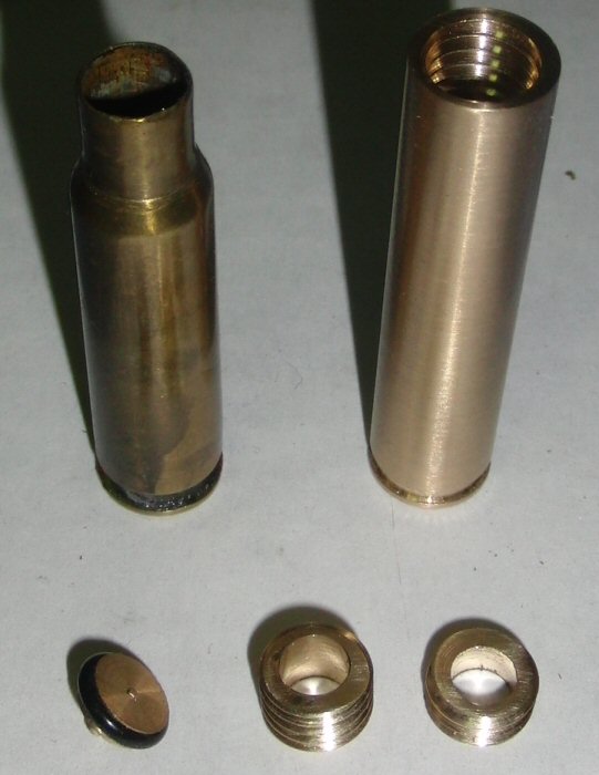

I'm giving this valveless design a go:
The o-ring is to be sandwiched between two threaded sections in order to make the pop-off pressure adjustable <sup>TM</sup>
There's still epoxy involved, curing as we speak :)
Here it is compared to a 7.62 NATO cartridge.
