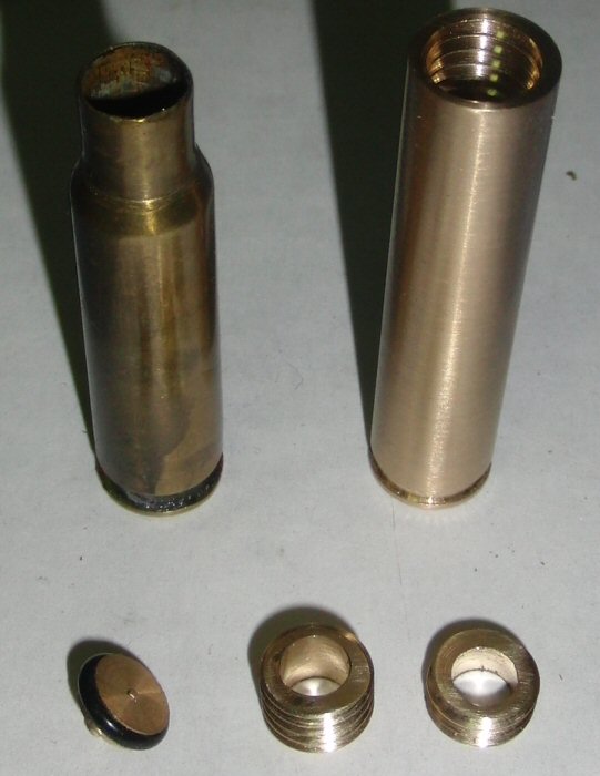

Wed Jul 06, 2011 6:16 pm
JDP12 wrote:if JSR had a CNC machine.... I believe the world may well be under his control... Because then he wouldn't have to wait 24 hours for every single project to even start testing.....
Well, not CNC yet, but we're getting there :)
I'm giving this valveless design a go:
The o-ring is to be sandwiched between two threaded sections in order to make the pop-off pressure adjustable <sup>TM</sup>
There's still epoxy involved, curing as we speak :)
Here it is compared to a 7.62 NATO cartridge.
