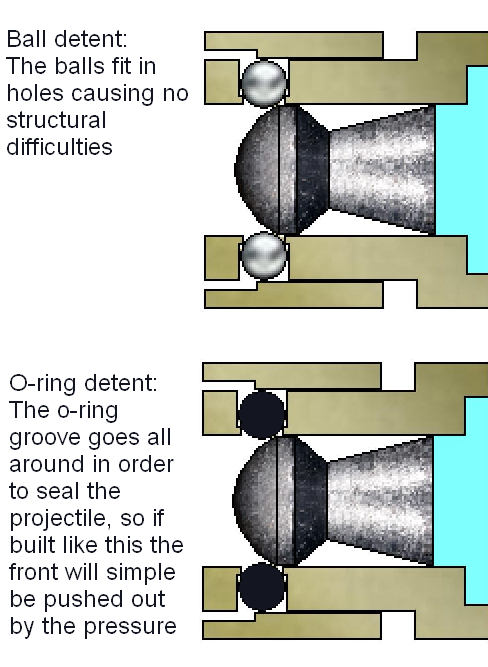

I'm confused as to why this needs to be so complicated... Or are you simply looking for a way to trigger the detent?
Sat Aug 06, 2011 12:31 am
saefroch wrote:I'm confused as to why this needs to be so complicated...
saefroch
Posts: 1679
Location: U.S.A.- See Map
Sat Aug 06, 2011 12:38 am
And those are difficult to machine?
Sat Aug 06, 2011 12:47 am
saefroch wrote:And those are difficult to machine?
Those what exactly?
saefroch
Posts: 1679
Sat Aug 06, 2011 1:16 am
The detent designs.
Sat Aug 06, 2011 1:31 am
saefroch wrote:The detent designs.
The ball detent designs are relatively easy to make, I know because I've made one already.
An o-ring detent is however preferable for several reasons, namely it has the dual function of both holding and sealing the projectile, as well as holding the projectile over its entire circumference as opposed to specific points like the ball detent.

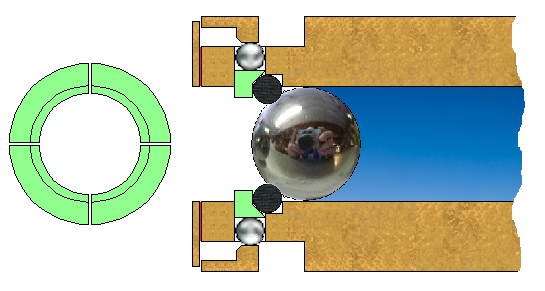

OMG!
I might have simplified the design... well... sorta...
It's easier to machine at least ;-)
lots of holes, no thread (look Ma!), and a bit of epoxy for flavour.
I HAZ A BANG!

Is that your camera in the reflection on the bearing? :lol:
The problem is still how to secure the front for the oring can stay in place.
Sat Aug 06, 2011 8:12 am
LeMaudit wrote:lots of holes, no thread (look Ma!), and a bit of epoxy for flavour.
I considered this but my fear is that not putting pressure on the o-ring evenly will cause it to leak, and anyhing more than 4 holes is pushing it for a cartridge.
Making another attempt at a "conventional" burst disk hybid cartridge in the meantime :)
Yes, I totally didn't take a stock image from the interwebs or something :D
LeMaudit
Posts: 665
Sat Aug 06, 2011 8:53 am
What do you mean?
Under pressure the ball will seal against it, and adjusting the dimensions of the o-ring/ball diameter to have the appropriate recess for the o-ring should do the trick? (it could be tricky though)
[edit] now understand what you mean... I had to check again "evenly" on the english dictionary :lol:
Are you concerned about the brass resistance that could break with all the holes in the circumference of the o-ring? hmmm... maybe... but it can be pretty thick by adjusting this design dimensions.
IMO if the o-ring is capable of keeping the projectile without tearing, the brass will keep its integrity, even with several holes in it. I believe the o-ring will be crunch way before the brass tear apart.
But the truth is I would have very little confidence in this idea of using a o-ring to keep the projectile from been fired... it would certainly not be my final choice; I find it way way too dangerous for a cartridge. My addition doesn't change the original's unsafe design (again, IMO)

This one would have a evenly :-D seal, well... almost all around, here in green a simple brass or steel ring split in 4 (or more) sections. Easy to do for a "Man with Machines" :wink:
The small ball bearings would limit friction for the external ring detent.
And I feel this is safer, because if the o-ring fail, it will leak air without letting the projectile shoot (right in your eye).
I HAZ A BANG!
Sat Aug 06, 2011 12:18 pm
LeMaudit wrote:But the truth is I would have very little confidence in this idea of using a o-ring to keep the projectile from been fired... it would certainly not be my final choice; I find it way way too dangerous for a cartridge. My addition doesn't change the original's unsafe design (again, IMO)
I can personally attest that an o-ring detent will hold a projectile after a 20x mix combustion ;)
This one would have a evenly :D seal, well... almost all around, here in green a simple brass or steel ring split in 4 (or more) sections. Easy to do for a "Man with Machines" Wink
This looks like it will work! But for a cartridge, too many parts...
I don't doubt that for a single second... but will it hold it safely enough for you to put the cartridge in your pocket, near some... say... private parts?
Without a positive strong lock that forbid the firing no matter what could go wrong, this design awaken the chicken in me :lol:
Safety measures apply to loaded guns, but when you manipulate a cartridge, you may point it in whatever direction without thinking.
A Brockock cartridge have his load of parts too. And you know now that a single part with a difficult cut can take as much time as 10 simple ones.
For a full auto, it's most certainly too complex to build in quantity... but for a 6 shooter, hey.. I kinda like the design! It's certainly the most compact, safer and better sealing that I imagined so far for this kind of locking mechanism.
The splitted ring, which is the most complex part, could be made easily with a bit of planning, starting with thick walls tube and cutting/splitting in sequence.
I HAZ A BANG!

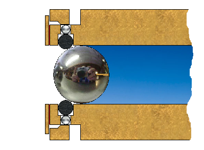

Sat Aug 06, 2011 1:37 pm
Had an idea in the shower combining balls and ring, but I'm running late so no tine to sketch, hope I remember it when I get back!
