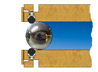

Is that your camera in the reflection on the bearing?
The problem is still how to secure the front for the oring can stay in place.
I considered this but my fear is that not putting pressure on the o-ring evenly will cause it to leak, and anyhing more than 4 holes is pushing it for a cartridge.LeMaudit wrote:lots of holes, no thread (look Ma!), and a bit of epoxy for flavour.
Making another attempt at a "conventional" burst disk hybid cartridge in the meantime
Yes, I totally didn't take a stock image from the interwebs or somethingIs that your camera in the reflection on the bearing?
What do you mean?not putting pressure on the o-ring evenly will cause it to leak
Under pressure the ball will seal against it, and adjusting the dimensions of the o-ring/ball diameter to have the appropriate recess for the o-ring should do the trick? (it could be tricky though)
[edit] now understand what you mean... I had to check again "evenly" on the english dictionary
Are you concerned about the brass resistance that could break with all the holes in the circumference of the o-ring? hmmm... maybe... but it can be pretty thick by adjusting this design dimensions.anyhing more than 4 holes is pushing it for a cartridge.
IMO if the o-ring is capable of keeping the projectile without tearing, the brass will keep its integrity, even with several holes in it. I believe the o-ring will be crunch way before the brass tear apart.
But the truth is I would have very little confidence in this idea of using a o-ring to keep the projectile from been fired... it would certainly not be my final choice; I find it way way too dangerous for a cartridge. My addition doesn't change the original's unsafe design (again, IMO)

This one would have a evenly
seal, well... almost all around, here in green a simple brass or steel ring split in 4 (or more) sections. Easy to do for a "Man with Machines"
The small ball bearings would limit friction for the external ring detent.
And I feel this is safer, because if the o-ring fail, it will leak air without letting the projectile shoot (right in your eye).

This one would have a evenlyseal, well... almost all around, here in green a simple brass or steel ring split in 4 (or more) sections. Easy to do for a "Man with Machines" Wink
This looks like it will work! But for a cartridge, too many parts...
Stranger things have happenedInsomniac wrote:JSR probably isn't daft enough to make such an obvious mistake... ...Probably.
I don't doubt that for a single second... but will it hold it safely enough for you to put the cartridge in your pocket, near some... say... private parts?I can personally attest that an o-ring detent will hold a projectile after a 20x mix combustion
Without a positive strong lock that forbid the firing no matter what could go wrong, this design awaken the chicken in me
Safety measures apply to loaded guns, but when you manipulate a cartridge, you may point it in whatever direction without thinking.
A Brockock cartridge have his load of parts too. And you know now that a single part with a difficult cut can take as much time as 10 simple ones.This looks like it will work! But for a cartridge, too many parts...
For a full auto, it's most certainly too complex to build in quantity... but for a 6 shooter, hey.. I kinda like the design! It's certainly the most compact, safer and better sealing that I imagined so far for this kind of locking mechanism.
The splitted ring, which is the most complex part, could be made easily with a bit of planning, starting with thick walls tube and cutting/splitting in sequence.
