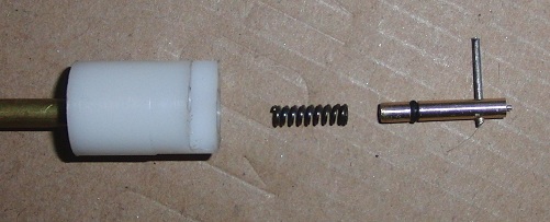

Just an idea, what if you put a bolt behind the spring (left side on the diagram) so you can thread it in and out to adjust the spring pressure? Just a thought.
Has thanked: 581 times
Tue Dec 06, 2011 3:18 pm
Put it on hold for now, a bit fiddly in the dimensions I chose. Started on something else in the meantime, trying to see if the Monsoon loader will work at lower pressures, watch this space :)

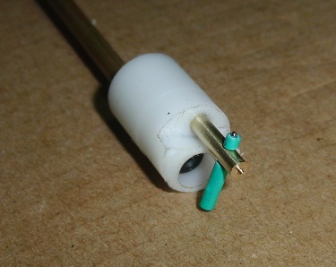

I started on this but realised that my smallest o-ring for the blocket piston wouldn't fit, so I have to remake it with the barrel mounted off-centre.

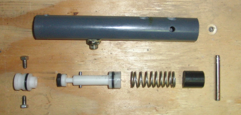

Some progress on this, should have it ready for testing tomorrow.
Fri Dec 09, 2011 3:52 pm
Well it sort of works... testing at 850 psi:
I have a feeling cloud feeding is never going to be reliable enough...
