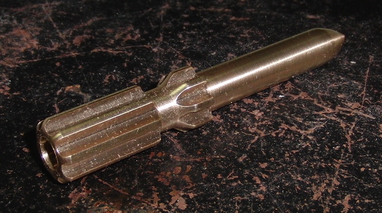

Here's what I have in mind for the dart, 8mm body diameter and six fins.
Fri May 11, 2012 3:55 pm
Petitlu wrote:Wow!
Wonderful and beautiful!
Cheers
How many time to do it?
Enough not to make mass production feasible

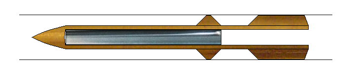

I also need to make a delrin plug to stop the tungsten's inertia making it fall out...

And if is glued the tungsten? a little hot glue or epoxy ...
The stainless steel point was glued with hot glue on the aluminum body
Fri May 11, 2012 4:15 pm
Definitely will need some epoxy, but it's better to have something physical between the pusher plate and the tungsten.

But the tail should not be heavy ...

Gun Freak wrote:Won't the brass nose just get crushed?
Yep,
read up
Tungsten: 19.25 g/cm<sup>3</sup>
Delrin: 1.42 g/cm<sup>3</sup>
I
think balance will be fine
Your missile weighs how much?

With tungsten carbide it will weigh 38.46g, practically 40g with delrin!

you'll put the delrin like that?

Petitlu wrote:With tungsten carbide it will weigh 38.46g, practically 40g with delrin!
More muzzle energy but lower velocity, so less chance of the tungsten core shattering. I want this thing to go through both flanges of the beam
Like this:
