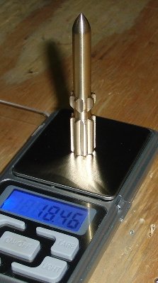

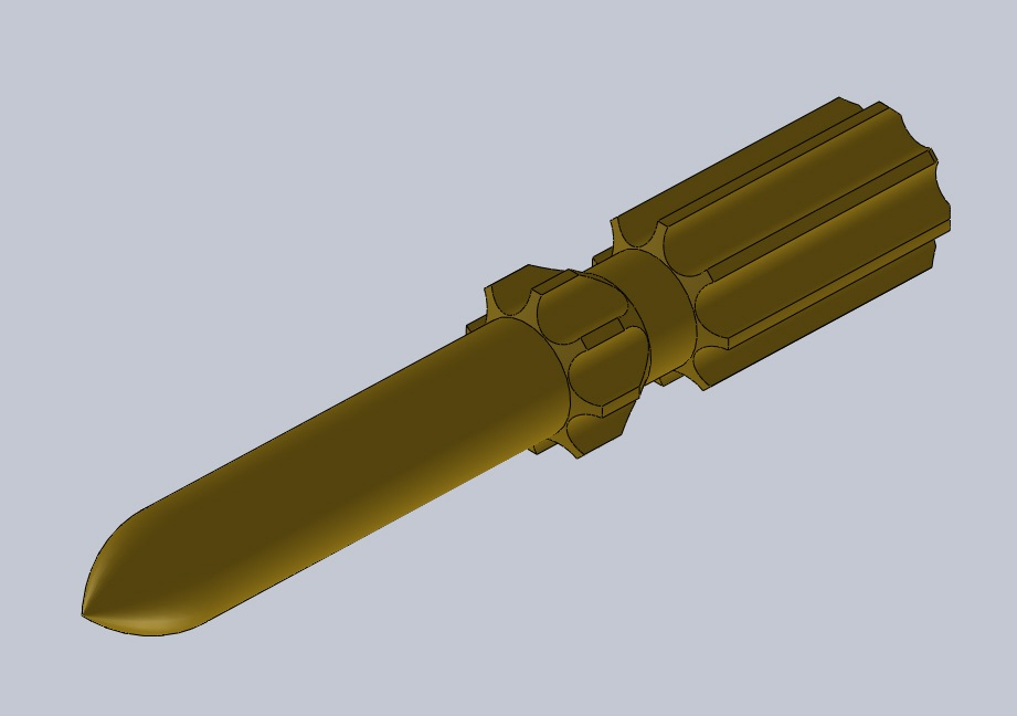

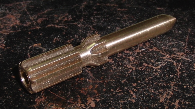

Here's what I have in mind for the dart, 8mm body diameter and six fins.

very nice!
complex to do ... the fins are made ​​separately and glued?
Fri May 11, 2012 11:34 am
No, all from one solid piece of brass.
Not that complex to do.

Fri May 11, 2012 11:41 am
ok brass, delrin I thought ...
fins are not high ...

Fri May 11, 2012 3:45 pm
Wow! :shock:
Wonderful and beautiful!
How many time to do it?
Fri May 11, 2012 3:55 pm
Petitlu wrote:Wow! :shock:
Cheers :)
Enough not to make mass production feasible ;)

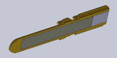

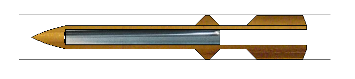

I also need to make a delrin plug to stop the tungsten's inertia making it fall out...

And if is glued the tungsten? a little hot glue or epoxy ...
The stainless steel point was glued with hot glue on the aluminum body
Fri May 11, 2012 4:15 pm
Definitely will need some epoxy, but it's better to have something physical between the pusher plate and the tungsten.

But the tail should not be heavy ...
Finally you know very well!
:wink:
Your missile weighs how much?

Fri May 11, 2012 5:06 pm
Won't the brass nose just get crushed?
Fri May 11, 2012 11:18 pm
Gun Freak wrote:Won't the brass nose just get crushed?
Yep,read up ;)
Tungsten: 19.25 g/cm<sup>3</sup>
Delrin: 1.42 g/cm<sup>3</sup>
I think balance will be fine ;)

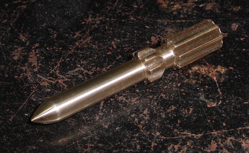

Sat May 12, 2012 2:38 am
it is beautiful! it shines!

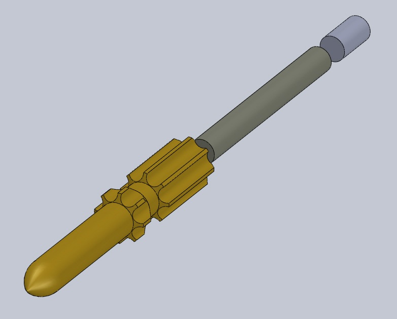

With tungsten carbide it will weigh 38.46g, practically 40g with delrin! :shock:
EDIT :
you'll put the delrin like that?
Sat May 12, 2012 3:50 am
Petitlu wrote:With tungsten carbide it will weigh 38.46g, practically 40g with delrin!
More muzzle energy but lower velocity, so less chance of the tungsten core shattering. I want this thing to go through both flanges of the beam :D
Like this:
