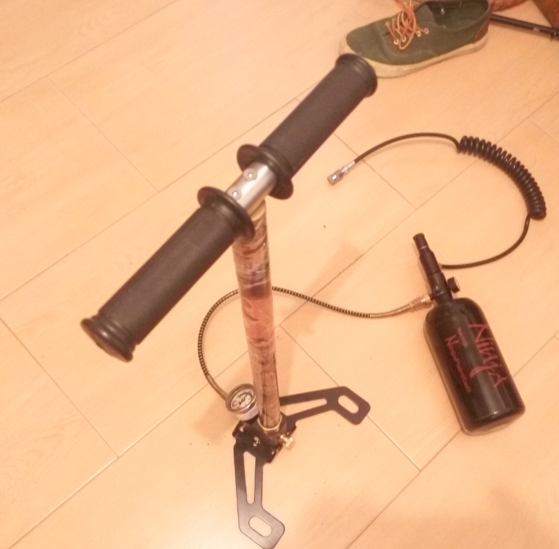

So the paintball tank, adjustable regulator, adapter & pump arrived. I also got another QEV & Slide vavle.
I removed 2 shims from the regulator to get about 550 PSI of output pressure.
It took me about 20 minutes (with 1 minute brakes every 5 minutes) to pump the 48/3000 tank to 3000 PSI.

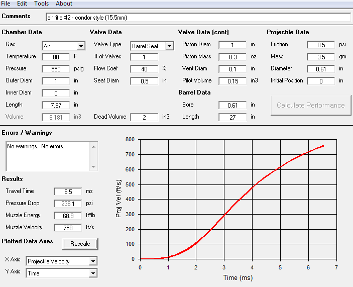

GGDT data:
15.5mm condor
15.5mm condor
10mm
10mm

I removed on more shim from the regulator & now the slide valve is moving smoothly. got a different problem now (it seems like a never ending project, but i like it): the PCP pump stopped working, i guess i was pumping it to fast and one of the O-rings went bad.. I'll rebuild it this weekend (came with a rebuild kit) .

Good news! I managed to fix the pump, one of the O-rings was damaged, i guess it came this way from the factory, but what can you expect from a 70$ chinese pump :lol: it works fine now & i got an extra o-rings kit.

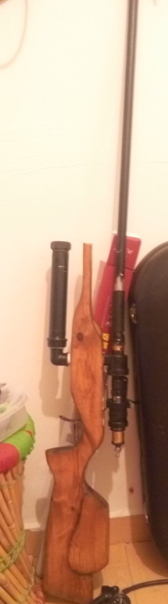

here is the stock i made for the old 15.5mm condor style rifle, it's not finished yet.. still got some sanding & shaping to do, but i'm getting there.
after that i'll mount the 3-9X40 scope on it.

to avoid barrel potentially choking
This isn't really an issue per se, GGDT tells you this to say that you can have a bigger barrel if you want. That being said, with a smaller QEV you'll get more efficiency.
here is the stock
Nice!

Ok, I'm all finished with the 15.5 mm rifle now. I used some silicone grease on the slide valve, cleaned the barrel, mounted a scope and Voilà - it's beautiful!
I did some shooting - 10 meters away the 54 grains nail darts went thourgh 3\4" plywood like butter and got stuck in the wall behind it. accuracy really improved, i guess the consistency in pressure helps :D

can't wait to build the 10mm one (allready got 63 grains bearings balls for it) , I think i'll make the air chamber half the size (50cc) this time, GGDT tells me that velocity won't be affected much by it (gotta get a chronograph), and i suspect it will increase (double :?: ) the amount of shots .
