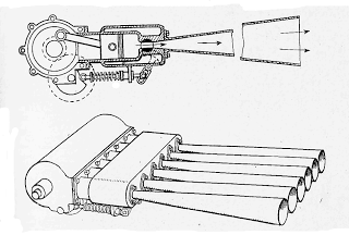

It is just as I always thought that an automatic hybrid could be built. You have everything there. It is necessary to block the crankshaft, in one direction, in the compression stage, with the piston at its top dead center, and the firing barrel in the exhaust valve, which has to be modified. Maybe it is possible, in the same way, with a two-stroke engine. The electrical system remains as it is, and the crank to make it shoot goes in the crankshaft. You could attach an electric motor to make everything work. As I said in a previous post, with a 4-stroke 125cc engine, it would be great. There are several problems to be solved but I think it can be.A hybrid projectile launcher is essentially an internal combustion engine with a single piston that buggers off, it's not like we came up with the idea
It is this diagram that you find on the web, a multi cylinders engine is used as a jet engine! Of course, if we replace the nozzles with shotguns ... We could have an automatic hybrid.

I think a single barrel design like that could work with a piston that uses an air-spring system near the barrel opening and a self feeding magazine. You could have two other pistons that operate like a normal engine on either side of the shooting piston and they could power the shooting piston and the whole thing could just run on gasoline. You'd need high temp materials, like a car engine of course, but I think that could actually work and I don't even think it would be that hard.

Another way of doing things could involve the same principles in electric airsoft guns:It is this diagram that you find on the web, a multi cylinders engine is used as a jet engine! Of course, if we replace the nozzles with shotguns ... We could have an automatic hybrid.
You already have a compression and reloading cycle, all that would be needed is to add a fuel dosing and ignition element.
You would also have to cater for the fact that the propellant pressure is going to try and re-cock the piston, in fact the motor might not even be necessary in reality.

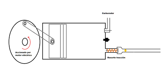

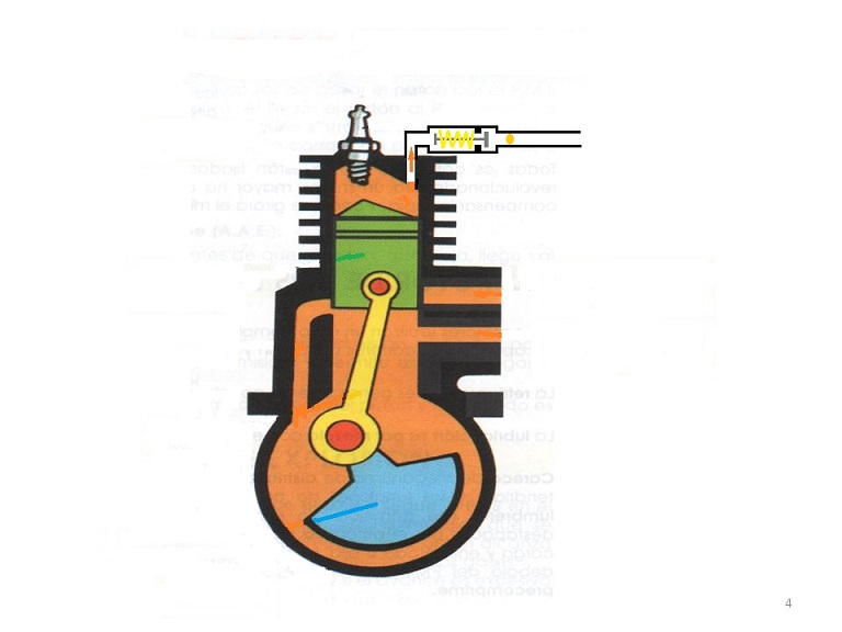

What you have to achieve is not to invert the energy of the combustion in moving the piston and to make force in the axis of the crankshaft, to leave all the energy for the firing. There would be two ways of looking at this topic, 1, blocking the crankshaft in one direction, and another by moving the crankshaft with an electric motor, (standard engine starter).
The engine is designed at the factory to produce the ignition just at the top dead center of the piston, and that suits us. I leave a picture of how it can be, it is an escape system. The spring works by pulling and opens when the pressure peak is occurring. It should be a hard, logical spring.
It could work with ordinary gasoline and with the normal carburetor. I "hear" it in my mind, like a motor that is starting ... and firing

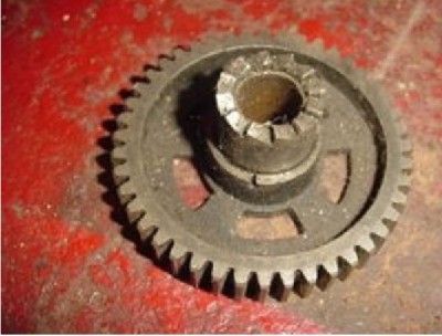

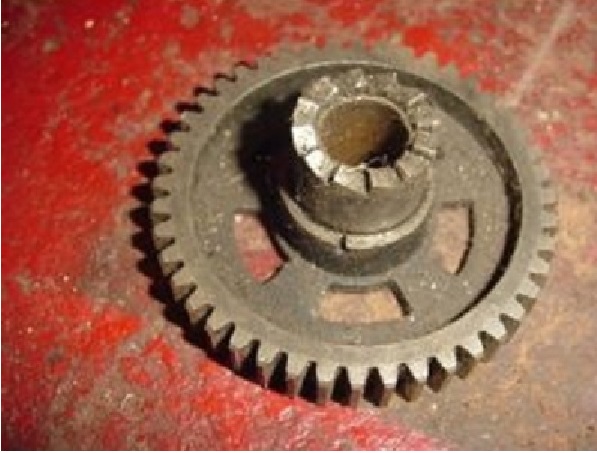

With a 2-stroke engine, (less price and are smaller), I think it could work equally ...A double gear of those used for the start lever can be used to block the rotation of the crankshaft in one direction, and to link the crankshaft with the electric motor that rotates it, in the other direction. The large gear has the reduction to boost the electric motor.
I think that the moment of the explosion should be a few degrees of the forward turn, to prevent the piston from doing the mechanical work for which it was intended, a few degrees before the piston reaches top dead center.

The spring for a mix of 6x, is one of those that I have bought and tested. The electric motor could be a brushless with reduction because it needs force to back the piston. When the piston disengages, compresses the mixture and when it is at its right point, a simple mechanism activates the ignition, and triggers. The doser is like the one I use myself, with some modification, and the ammunition loading system, of the mechanical type, associated with the electric motor. It is much more manageable to try it with a system of this type, because the one that can use a motor of explosion, it is necessary enough tools that normally have those that are professionally dedicated to repair this. I like the concept.Another way of doing things could involve the same principles in electric airsoft guns:

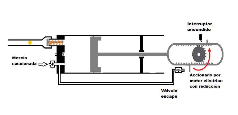

I would only use the engine with its corresponding reduction, to move the piston in both directions.
To the right sucks the mixture of air and gas from the dispenser, and to the left, compresses the mixture. When it is in its firing pressure, right there, the switch is activated by the piston rod so that the firing occurs.
The outlet valve must be adjustable to calibrate the weapon.
The motor moves the rod with a single-gear oscillating bar mechanism. I leave a video of how this mechanism moves, and a picture of the concept we are talking about here.The system must be able to block the movement of the piston during the explosion, so it must be robust.
