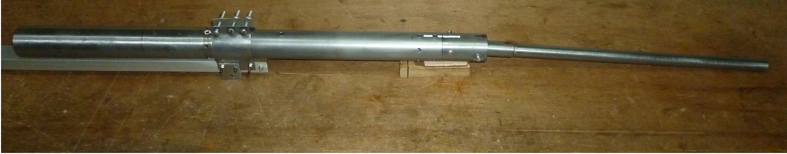

I did some tests with 6.35 mm lead pellet. Obviously, the power of the shot is not as much as it happens with the bb steel and retention system with o'ring. This was 8X. While firing forcefully, the resistance offered by the pellet in the rifled barrel is much less than the resistance that occurs when the steel bb has to go through the tight o'ring.
Now I am installing the bb's 1/4 "system to compare the results, I should drill a 0.8mm steel plate without problems, which the lead pellet can not do.
As a learning I take clean, it is not convenient to use this system for pellet, I mean the piston and spring system. This works great for bb with retention. For pellet and rifled barrel, (without retention of any kind), it is better to use a normal piston valve.
I leave a picture of the installation of the system for bb's of steel of 1/4 ", (that I want to do again for bb of 8 mm), in the present.
Otherwise, everything works very well, not having a single misfire in about 20 or 25 shots, 8x, and 10 ml of butane gas. The air pump and valves, work excellent. There is a significant improvement over the other hybrids. The only thing that is unfavorable is the weight of the weapon, which is around 2800 gr ... but it's not much.

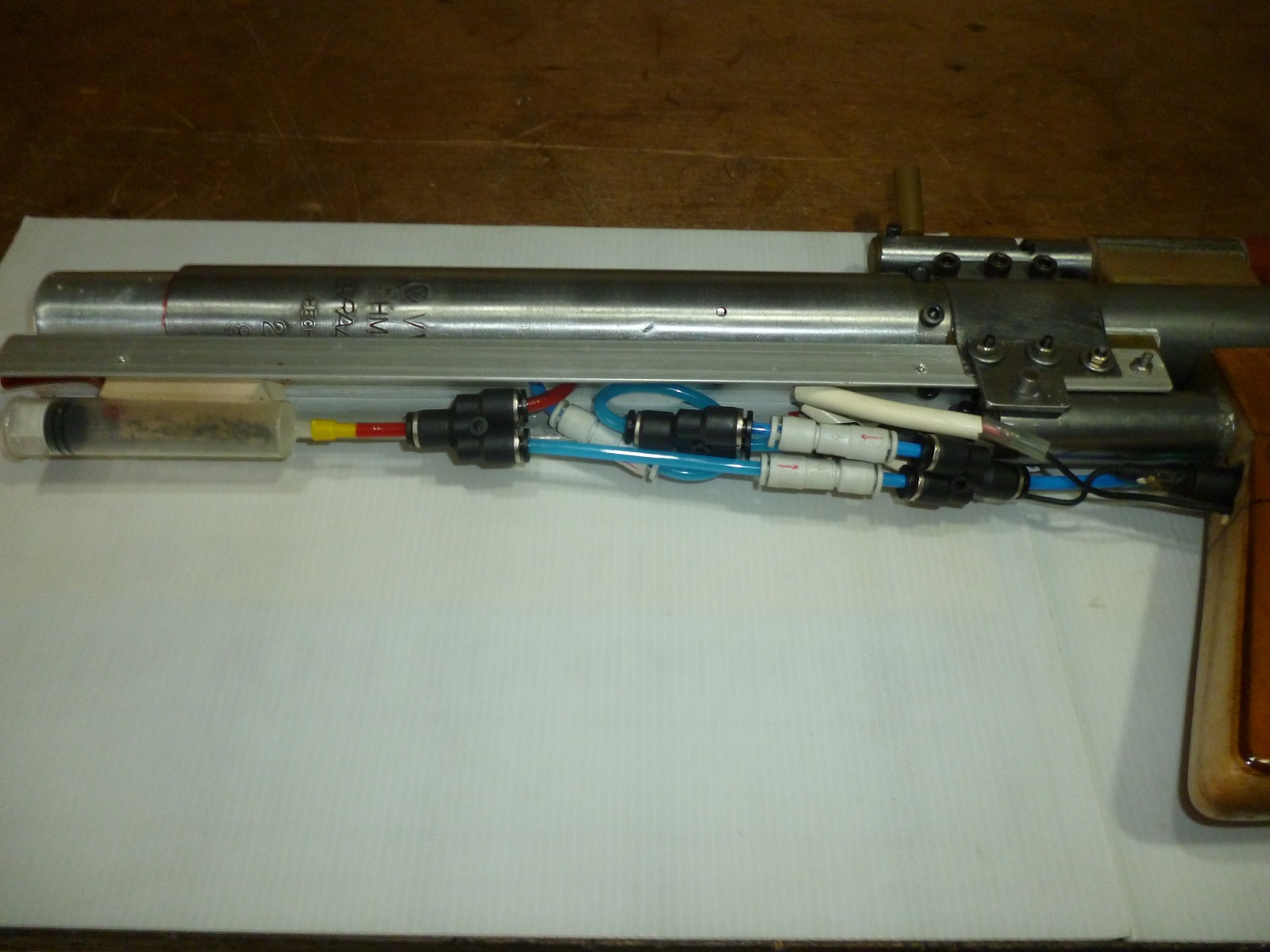

The weapon is almost finished. I still need to build shoulder support and install the open sights.
It is shooting bb 1/4 ", to 8X, in the future, when it has more shots made, I will go up to 9X which is the programmed pressure for this hybrid.
I have already tried it and it has enough energy when firing. Burns 10 ml of butane, which is what I provided the volumetric dispenser.
It is interesting to note that the noise is very little, and this is due, in my opinion, to the fact that the pressure drops a lot in the firing barrel, and when hot air comes out of the muzzle, the pressure is low, and the sound not very loud. Much of the pressure has been transformed into kinetic energy, throughout the length of the barrel. It does not need a silencer
, because the only thing that makes noise, (it is inevitable), is the objective plate, steel of 0.8 mm, perforates them without any problem, although the projectile is light. I will finish the stock and paint something in the near future.
The firing barrel has a PVC tube on the outside, to improve the finish. Tube to build it in two parts, because it is easier to give the exact caliber, and the union reinforced with fiberglass, looks and looks bad. Inside is a 5/8 "hard brass tube and the resin core lubricated with graphite.
I leave a photos of the bronze piece that compresses the ammunition retention o'ring, of the air pump, (very light to operate, goodbye discomfort in my left arm), and of the weapon as it is in the present.

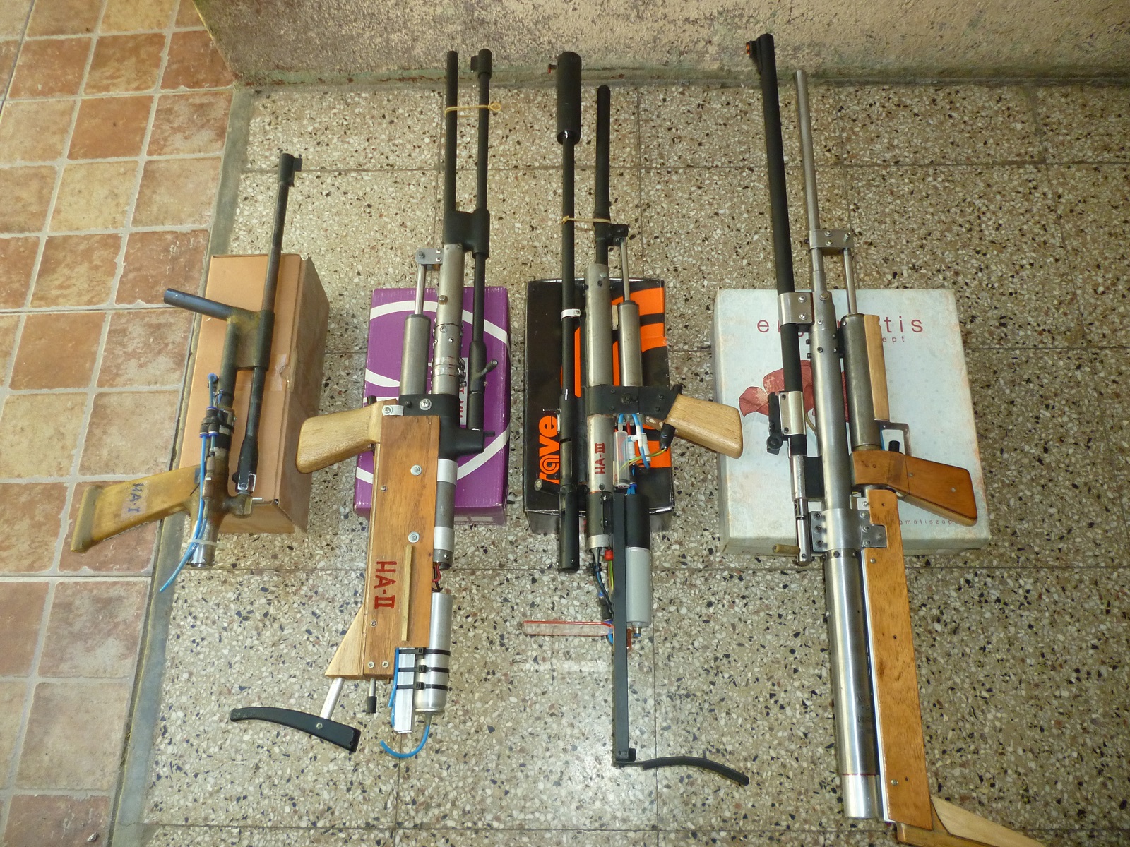

Finished project.
I made a photo of some parts of the HA-IV gun, and a general photo, of all the prototypes manufactured in this project.
All shoot well. The first, on the left side, does not have the air pump, but it is still part of the series. The second, shoots 5.5 mm pellets, the third and fourth, shoot 1/4 "steel balls, and are the most powerful.
The two cartridges hybrids are missing, with a rupture disk, but I do not have them near at the moment, for this reason I have not included them in the photo.
These weapons were constructed with waste materials, recycled, and none of them has any part machined with a lathe or welding of any kind. Absolutely everything is manufactured by me, it was a very nice experience.
In the future, probably, I think I will give the HA-SA I the semi-automatic hybrid again, if time permits.
- Has thanked: 581 times
Fantastic, I love the family photo! Looking forward to see the latest addition to the menagerie in action
