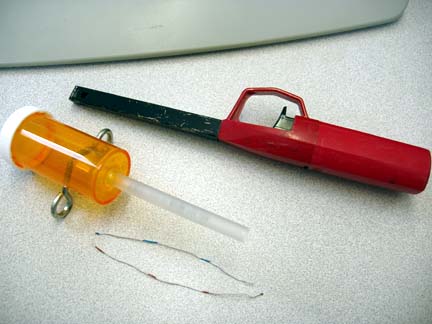

A friend of mine recently turned me on to the whole spud gun thing. After seeing everyone else's creations I have been itching to build my own. I don't have a ton of hardware lying around, and I wanted to get something going now, so I decided a mini pill bottle cannon would be a good shooter to start with. I put this thing together in less than an hour (had to wait for the epoxy to dry). I based it on PCGUY's pill shooter with my own modifications. I used a clear 2" pill bottle, a clear pen cylinder, two of those little hook screws used for hanging things, and a clicker and wires out of one of those long click lighters. It's very basic, but quick and very easy to make.
However I am having trouble getting the fuel to ignite. With the clear tube I can monitor the mechanics inside the chamber, and I can see that I am getting a good spark, but still no bang. As fuel I have used WD-40 and I have used Starting Fluid (aka. Diethyl Ether), but still no luck. Any advice?

WD 40 no longer has ingredients to make it a good fuel, starting fluid floods so easy its even hard to get to work in normal sized cannons

Tue Sep 27, 2005 5:20 pm
Bedo wrote:one spritz of binacca and your good to go
Excuse my ignorance, but what is binacca?

Tue Sep 27, 2005 5:33 pm
u have that lighter right? use the butane from it, a second or two.

Tue Sep 27, 2005 9:34 pm
Ok, I'll try the butane. Man, I've tried isopropanyl, cologne, and a few other things but still no bang. I'm only giving it one spritz into the chamber. Should I let it evaporate a little before closing the chamber or should I close it immediately after adding the fuel?

Tue Sep 27, 2005 10:28 pm
King Pow nice mini. I like how everything is clear. Hope it will work for you, it would be disapointing if such a nice gun didnt fire. If your using liquids let it evoperate a little but if your using butane screw the lid on as soon as you are done injecting the fuel.

Wed Sep 28, 2005 1:44 pm
I don't get where I've gone wrong. I'd hate to just toss it, but I've tried everything I can get my hands on, and it still won't fire. Butane, BlowOff (butane & propane), ice remover (isopropanyl), etc...
I still haven't tried the banacca, but with the poor luck I'm having with all the other stuff it may just be a waste of time. or is it???

Wed Sep 28, 2005 11:54 pm
AH HA!! I tried the Banacca and IT WORKS!
Being transparent, when it fires the whole thing lights up in a bright yellow glow! Thanks Bedo! My breath is minty fresh too! 8)
