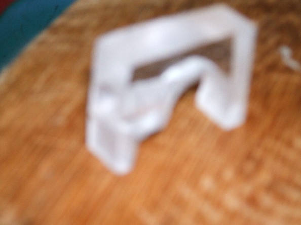

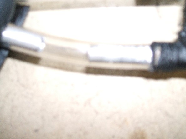

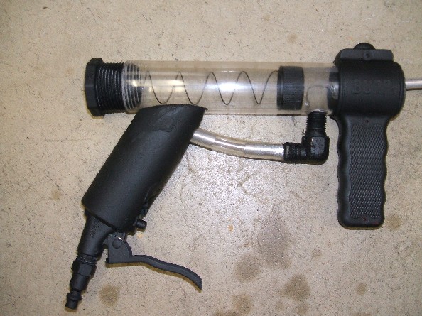

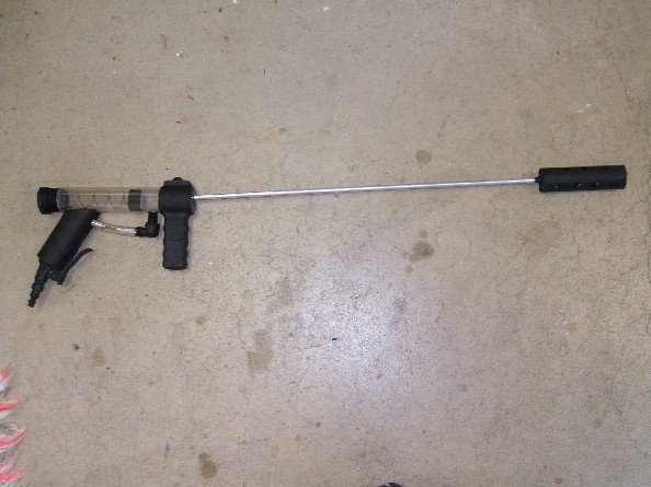

My newest airsoft strafer, thrown together for the competition. It utilizes a clear 1" SDR 21 chamber, a spring powered plunger, ghetto cut (but very clean) threads in the back, a 2 foot 9/32" brakeline barrel, a fake silencer that looks really kickass, a modified blowgun in a PVC handle, some clear epoxy, a clear vortex block with no shrouds and the front filed away for better feed, and some other stuff. It's about as strong as the Pocket Strafer but has a higher ROF and lasts longer (compared to the 1 second of firing out of the Pocket Strafer :lol: ).
Edit: Sorry for the bad pics.... :cry:

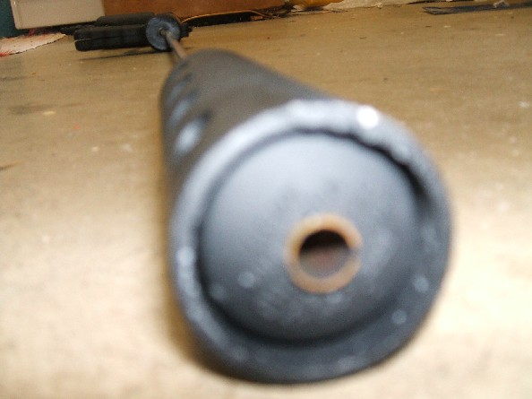

You DO NOT want to be here

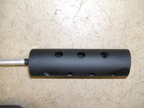

Kickass silencer
Kickass silencer

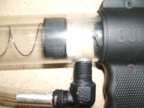

The plunger and air feed. The block was kind of covered by the flash
The air tube feed system

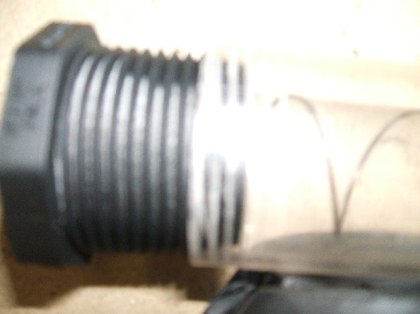

The self tapped threads, without a tap. I put a steel nipple up to the end, lightly blowtorched the pipe, and screwed the nipple in, blowtorching to soften the plastic when necessary.
Closeup of the body
Closeup of the body
Overall
Overall
The vortex block
The vortex block

Nice gun, but is that barrel angled upwards or is it just the photo?

I'm extremely sad I can't get a video. As you can see from the pics, my camera is shitty enough as it is.
The barrel is angled a tiny bit to increase long range accuracy, but the camera exaggerates it.

My favorite part is how you threaded that clear pipe. I wish I had those kinds of tools to work with. Great job.

Dude, I used a blowtorch and a steel pipe nipple! :D I heated the pipe and forced the nipple in with pliers, I don't know what kind of specialty tools you're talkin' about!
