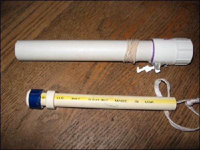

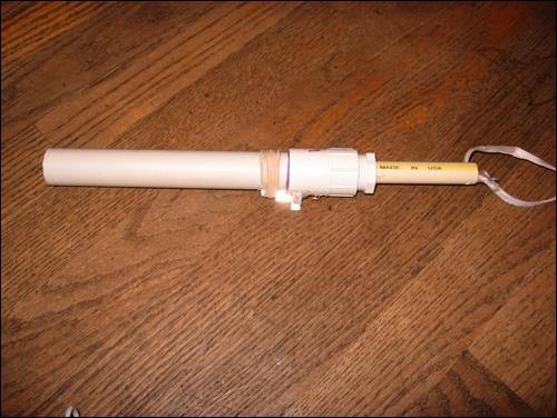

I tried making a mini nerf gun like this and ran into some problems.
1. Use an O-Ring. Don't use electric tape like the one gun on boltsniper.
2. I'm pretty sure your trigger mechanism needs to be flipped around. I found that the trigger didn't catch on the bolt very well. It did catch on the spring though because it's round. Even at this, it needed a lot of rubber bands to hold it.
If you want I can post pictures but I gave up on it so it's not much.

When you pull the bolt back, right now the catch is going to well catch on the spring so you won't be able to pull it back. The sloping side of the catch should be facing the front of the gun and the flat side of the catch should be facing the back.
I got like half way on this gun. When the first shot dribbled onto the floor 3 feet away, I threw it across the room and bawled my eyes out after wasting 2+ hours of precious time.
