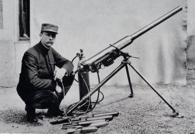

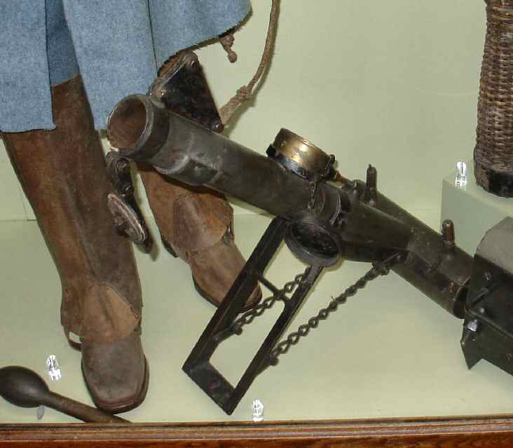

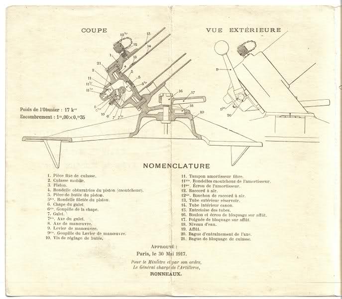

60 mm Pneumatic mortar Brandt: A coaxial pneumatic with an exaust valve that is actuated with a cam on a lever as opposed to a pneumatic pilot.

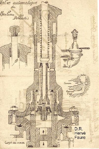

86 mm pneumatic mortar Boileau-Debladis: fired at a predetermined pressure using a pop-off valve to fire the projectile directly.
60mm brandt mortar.jpg (21.25 KiB) Viewed 26523 times

60 mm Pneumatique mortar Brandt...
...looks the best IMO :P

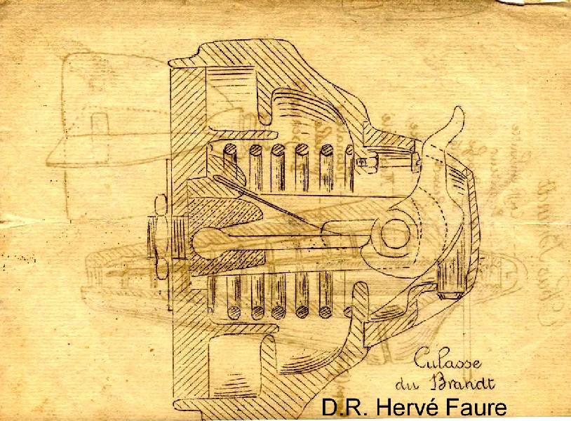

I don't see any indication that the Brandt 60mm is a coaxial... it's a CO2 gun :-)
How about the diagram ;)

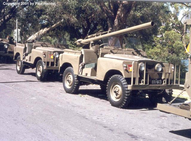

Don't you have a jeep :wink: ?
Yes, yes I do.
It would look cool with a 120 mm pneumatic mortar Brandt-Lhuillier mounted on the roof
Yes, yes it would :)
Last edited by jackssmirkingrevenge on Fri Mar 25, 2011 12:21 pm, edited 2 times in total.
:oops: Embarrassing...
I'm working on the translations :-D You'll do the proof-reading ;-)

The second certainly needs a caption, though it's the most "conventional", if I'm not very much mistaken, JSR made something of that ilk. A mechanically piloted coax that is.
/sarcasm, /hyperbole
Fri Mar 25, 2011 9:47 pm
Zeus wrote:The second certainly needs a caption, though it's the most "conventional", if I'm not very much mistaken, JSR made something of that ilk. A mechanically piloted coax that is.
You mean this one? Same concept but I dare say the mortar is slightly better engineered ;) Edgar Brandt was quite a guy by the way, it was his efforts that allowed the British to perfect the APDS shell in WW2.

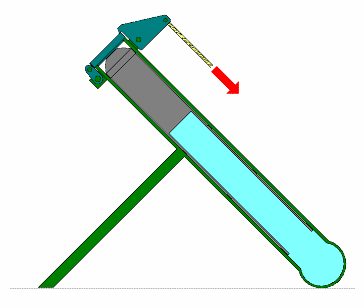

This is whatthis basic diagram of the device suggests. I remember a Junkyard Wars episode where they made a bowling ball cannon with a burst disk at the muzzle *cringe*
Here's how I would make it, much more efficient and the hollow tail also provides stability:
