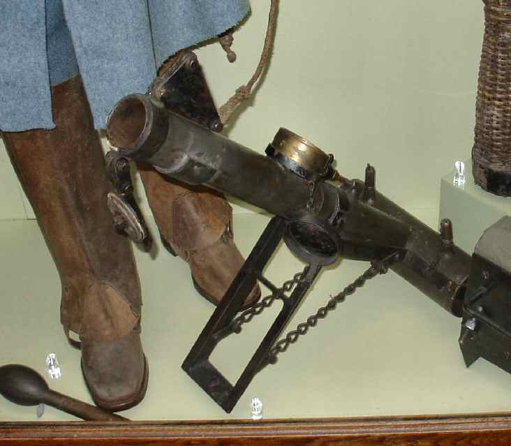

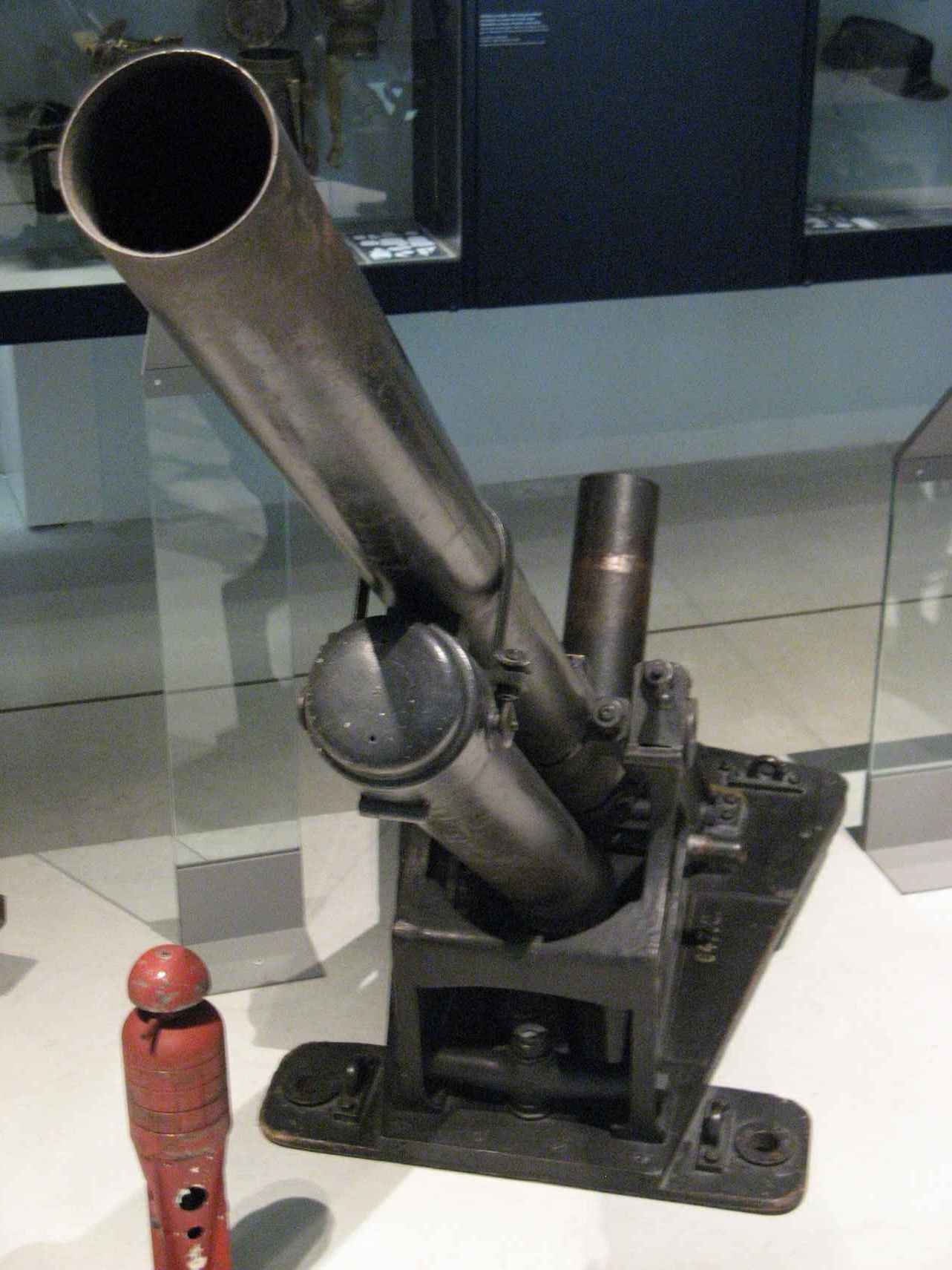

50 mm Pneumatic mortar Dormoy-Chateau: the mechanism appears to be a cap over the muzzle which allows the barrel to be pressurised, and the device is then fired by disengaging the sear holding the cap in place.

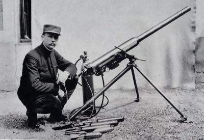

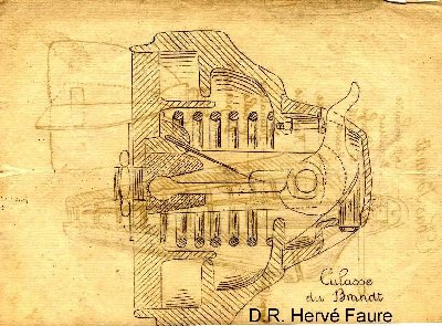

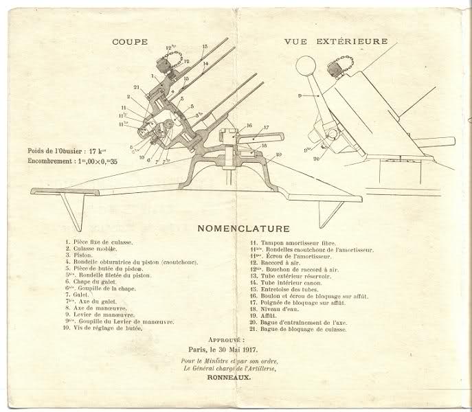

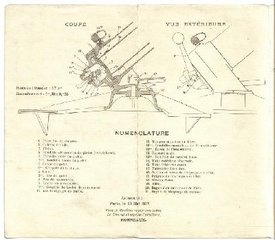

60 mm Pneumatic mortar Brandt: A coaxial pneumatic with an exaust valve that is actuated with a cam on a lever as opposed to a pneumatic pilot.

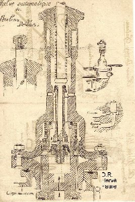

86 mm pneumatic mortar Boileau-Debladis: fired at a predetermined pressure using a pop-off valve to fire the projectile directly.

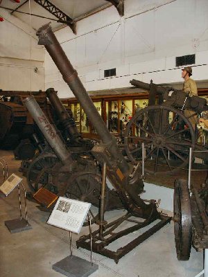

120 mm pneumatic mortar Brandt-Lhuillier: No indication of how this works but construction appears to be similar to the "valveless" luftminenwerfer designs.

The 50mm one reminds me of this design.
I think it's fascinating that in an age when solid propellant artillery was well developed and desensitised explosives could be fired from conventional guns (removing the need for weapons like the Zalinski Dynamite Gun), these devices were still considered to be viable weapons.
The static nature of trench warfare must have made the relative bulk of a pneumatic setup less of an issue, and the shot is of course both flashless and smokeless, so it is less likely to betray the position of the mortar. Still, I don't suppose it was noiseless - over 500 psi from a "valveless" pneumatic with a 5 inch bore must have made an impressive bang!

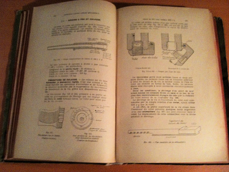

But I am not sure they were so common on the field; I have a big French book from 1923 named "Les Canons de la Victoire" (The Victory Cannons) full of drawings and descriptions for common guns and mortars, both heavy and light, and after a quick look I couldn't find a single mortar listed that operate with air pressure.

LeMaudit wrote:I have a big French book from 1923 named "Les Canons de la Victoire" (The Victory Cannons) full of drawings and descriptions for common guns and mortars, both heavy and light, and after a quick look I couldn't find a single mortar listed that operate with air pressure.
Sounds like an interesting item, is it original?

Yes it's an original book. Lots of detailed drawings in it :-D Love that!! 8)
I don't see any indication that the Brandt 60mm is a coaxial... it's a CO2 gun :-)

Quick & Dirty from the iPhone :-D
Sample pages
Sample pages
Cover
Cover

LeMaudit wrote:Yes it's an original book. Lots of detailed drawings in it :-D Love that!! 8)
Very nice, was it purchased or inherited?
How about the diagram ;)

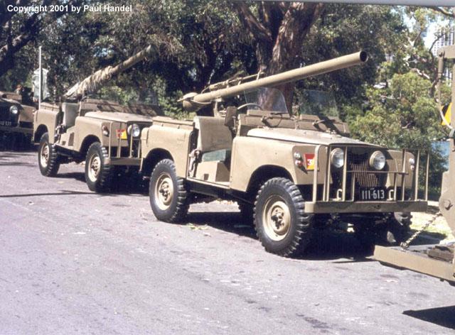

Don't you have a jeep :wink: ?
Yes, yes I do.
It would look cool with a 120 mm pneumatic mortar Brandt-Lhuillier mounted on the roof
Yes, yes it would :)
:oops: Embarrassing...
I'm working on the translations :-D You'll do the proof-reading ;-)

Do not like the 50mm mortar.
You'd have to dump a barrel of compressed air just to fire the projectile.

Although the inefficiency of the first design is quite obvious, it seems to have some potential, it certainly seems to be simple enough and the performance would be reasonable.
The second certainly needs a caption, though it's the most "conventional", if I'm not very much mistaken, JSR made something of that ilk. A mechanically piloted coax that is.

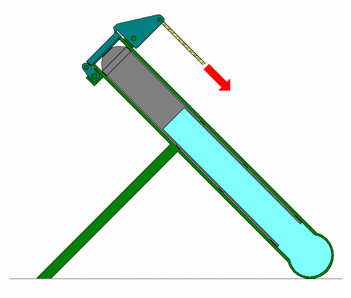

Zeus wrote:The second certainly needs a caption, though it's the most "conventional", if I'm not very much mistaken, JSR made something of that ilk. A mechanically piloted coax that is.
You mean this one? Same concept but I dare say the mortar is slightly better engineered ;) Edgar Brandt was quite a guy by the way, it was his efforts that allowed the British to perfect the APDS shell in WW2.
Hotwired wrote:Do not like the 50mm mortar.
This is whatthis basic diagram of the device suggests. I remember a Junkyard Wars episode where they made a bowling ball cannon with a burst disk at the muzzle *cringe*
Here's how I would make it, much more efficient and the hollow tail also provides stability:
