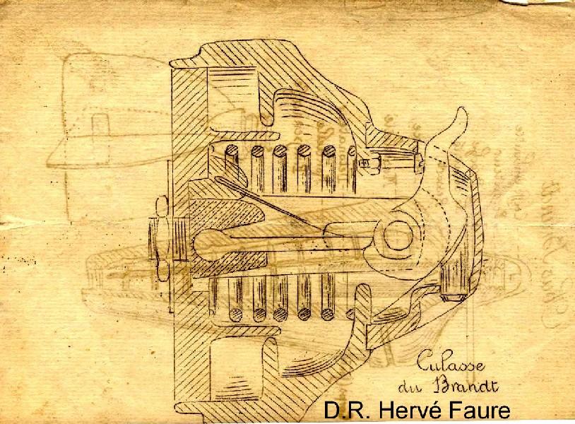

60 mm Pneumatic mortar Brandt: A coaxial pneumatic with an exaust valve that is actuated with a cam on a lever as opposed to a pneumatic pilot.

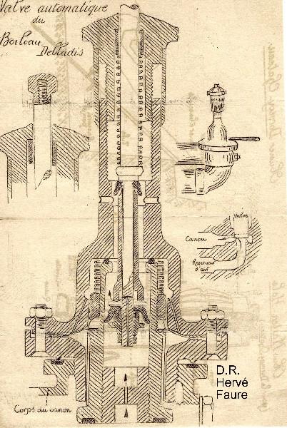

86 mm pneumatic mortar Boileau-Debladis: fired at a predetermined pressure using a pop-off valve to fire the projectile directly.

I don't see any indication that the Brandt 60mm is a coaxial... it's a CO2 gun
The web site is supposed to have English translation, but it doesn't seem to be available for those mortars.
Interesting subject, I'll grab what I can find here and there, and make an English translation from the various French description.
How about the
diagram

			jackssmirkingrevenge wrote:
Very nice, was it purchased or inherited?
I swapped it for my French Army medal
How about the
diagram
 Embarrassing...
I'm working on the translations
 You'll do the proof-reading

The second certainly needs a caption, though it's the most "conventional", if I'm not very much mistaken, JSR made something of that ilk. A mechanically piloted coax that is.

			Zeus wrote:The second certainly needs a caption, though it's the most "conventional", if I'm not very much mistaken, JSR made something of that ilk. A mechanically piloted coax that is.
You mean
this one?  Same concept but I dare say the mortar is slightly better engineered
